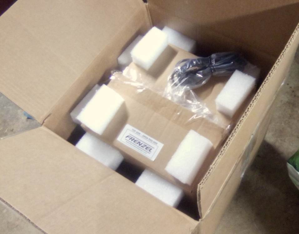

Here's the ideal from Frenzel. This has had a trip to the factory and back.

Thanks, guys! I went to UHaul and got the materials, and am doing my best to make it like the Frenzel pic above. My old Ridgerest sleeping pad is the foam I'm cutting up, and peanuts will fill any voids. Love this place because I know you will come through with sound advice on subjects like this! Huzzah!
If you are going to use peanuts, you have to encase the amp or it sucks to be on the other end. The corners are your weakest link, smallest area to absorb impact. Concentrate on them! The peanuts will have to be densely packed to be of any use. I would honestly forgo them. If the open areas bother you, stuff the 'nuts in large Ziplock bags and disperse them around the frame between the well-bolstered corners. They just provide a direct conduit to the baffle for any movement of the outer packaging. The open areas are crush zones.

I ended up skipping the peanuts. Everything is tight and well-padded. Amp is wrapped in bubble wrap under the slipcover, that's inside the "inner box, which is padded with the cut up foam sleeping pad, emphasis on corners, and finally, the outer box. No real room or need for peanuts. Thanks for all the help!
Since you have it done, this is more for peace of mind. They're more resilient than you'd think. As long as it ships right side up, and you packed it where the amp is tight in the box but there is some "spring" to the package when you shake it or drop it from a 1/4" or so, it will be fine unless the shipper does something stupid with it.
Last couple of amps I bought from the factory shipped in just one box, tubes in, but suspended in with foam corners and additional cardboard to make sure the amp didn't shift in the package, and two of those came from Germany. I also shipped a BE50 to Cali and back twice, and it was packed that way.
After destroying an amp due to stupid packing myself, I subsequently used to pack them like they were going to be dropped from an airplane.  After buying a few amps from Friedman, I started packing them like they advised.  The vast majority of the winning the war is making sure it can't shift in the box, that it can absorb a normal amount of shock from getting jostled around, and doing what you can to make sure if the shipper ignores the label and stack shit on it that it will distribute that load as evenly as possible without stressing any tender bits of the amp.
