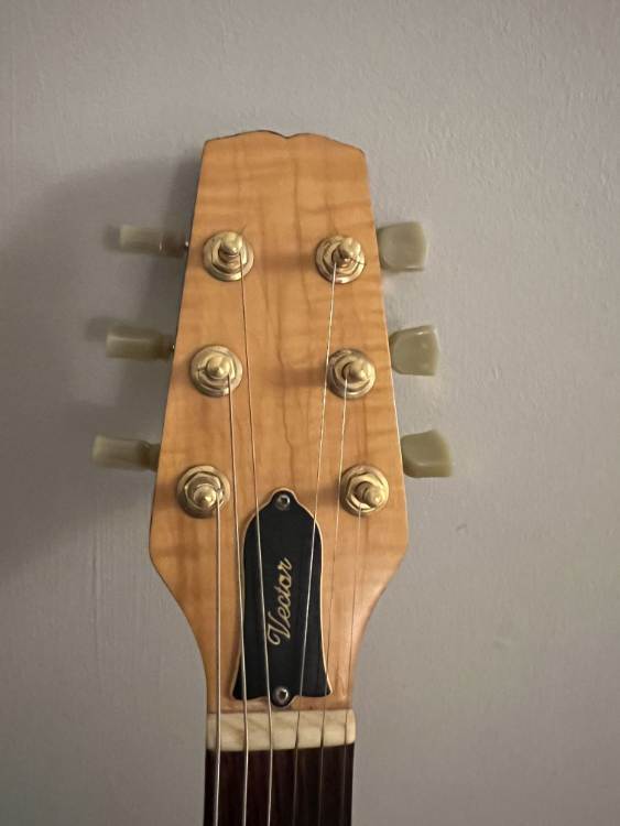

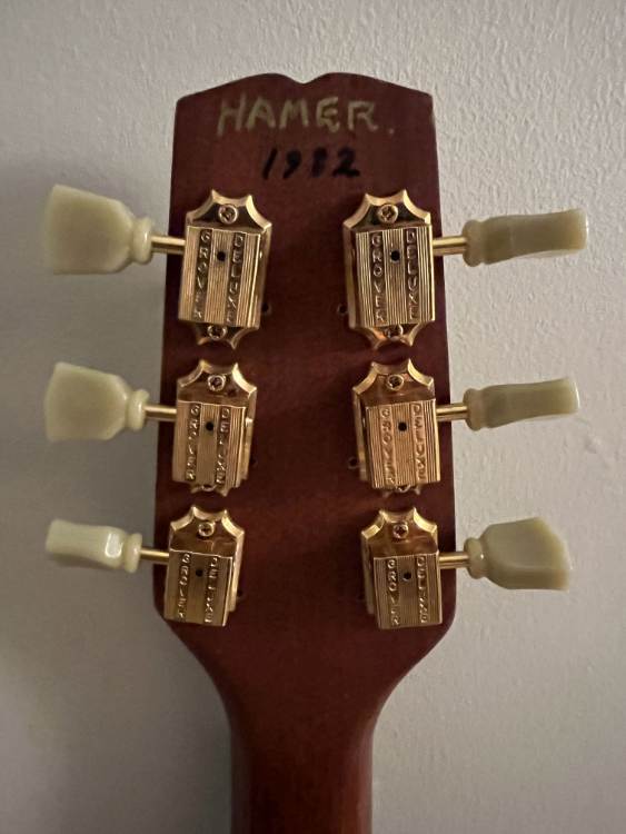

So as I'm settling in with the this somewhat bastardized Vector, I've decided I'm definitely going to start with replacing the tuners as that's something I feel comfortable doing myself. Are Schaller M6 3+3 the direct modern replacement?
Any sources on a proper headstock logo? I think, at least for now, I'll keep the natural headstock as I kinda dig the natural look. So a black logo would be cool.

If you’re interested, posting a WTB for period correct Hamer branded tuners could yield positive results. There are some pretty deep parts drawers around here.

If you search this site for "Dry Transfer" you should find the correct Logo.

The Schallers should be direct replacements "unless they reamed out the original holes to accept the Grover ferrules" but doubt they did that... you'll have 2 extra mounting holes to deal with... looks like the original holes are still there...

They will work. If you want to referb a 2006 Hamer import. But Hamer USA used Schaller made tuners in the 80's
I see original '80s Schaller M6 tuners (AKA the ones you really want) on eBay and reverb pretty often. You should be able to find some for $100 + or -

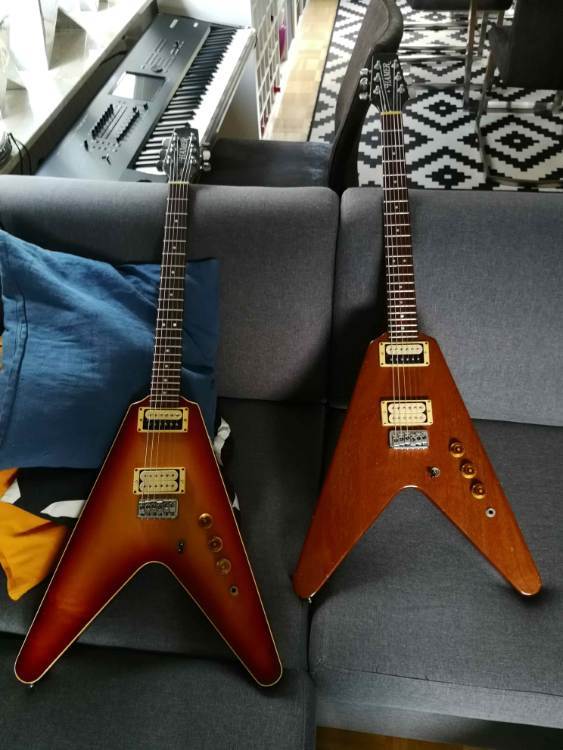

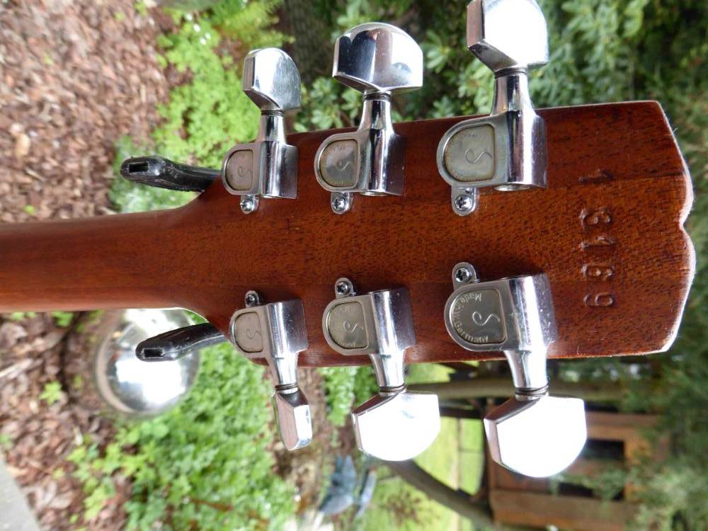

Perhaps these fotos help You.: Two Vectors with Schallers from 1981 and 1982. Important: "Made in W.Germany" (Reunification was in 1989, then Schaller left the "W.")
