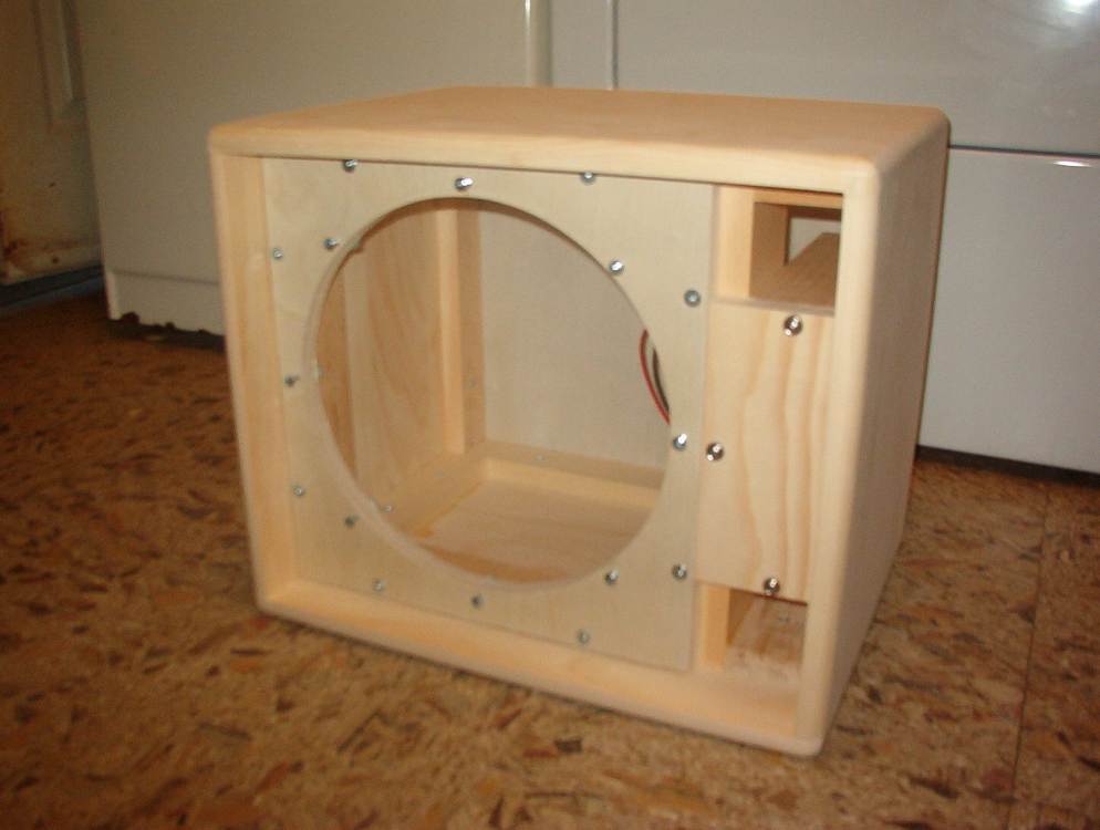

0 BoogieMKIIA Posted November 12, 2024 Posted November 12, 2024 1 hour ago, JGale said: Or buy one ready made, in either size, and finish it yourself. http://www.trmguitarcabs.com/ported-cabs.html I always wanted to try a TRM cab, are they good? They have pine and Baltic birch ply, lots of variations to choose from. Quote
