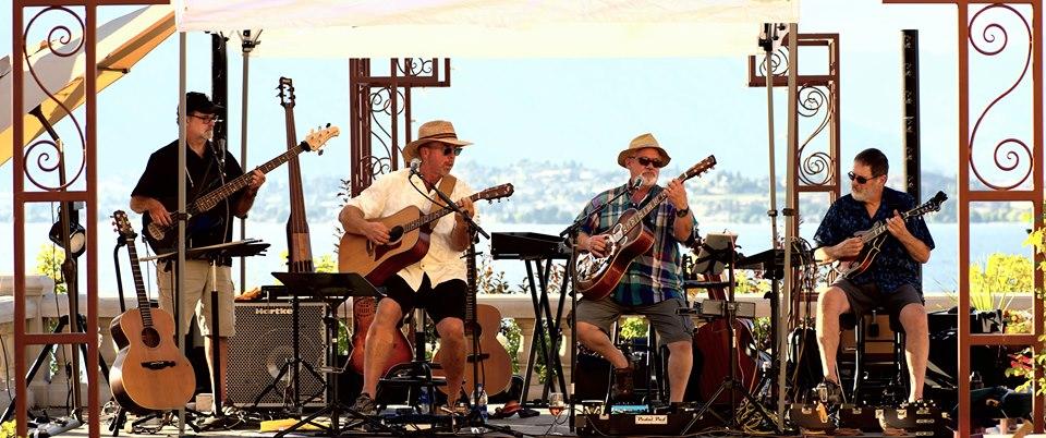

Camstone Posted September 3, 2019 Posted September 3, 2019 Bose +1 I play with an acoustic quartet and we use one or two of them depending on the size of the venue. They are awesome. We use the LI II systems which run about $2600 a piece, but Bose makes smaller systems as well. This is a shot from just this last Saturday. You can see them on the back corners.
Steve Haynie Posted September 3, 2019 Posted September 3, 2019 Your PA is behind the band. Are there ever feedback problems? The Dawn Audio speaker systems from years ago did not feedback, so someone had both monitors and mains with those tiny speakers. Their only drawback was a big scoop in the lower mids.

hamerhead Posted September 3, 2019 Posted September 3, 2019 32 minutes ago, Steve Haynie said: ....PA is behind the band..... That's the way they were for the band we saw. Loud, clear, and no feedback.
