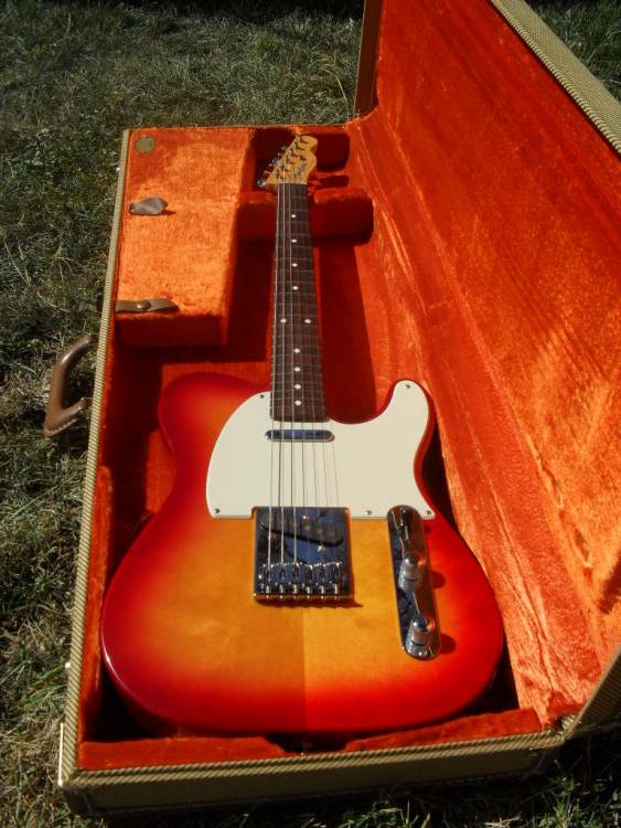

crunchee Posted April 25, 2020 Posted April 25, 2020 Anybody here have an old Fender American Standard Tele, where they didn't (or don't) get along with that guitar's original six-saddle bridge? I do, the bridge on mine was the type used by Fender from 2008 to 2016, with Strat-style bent steel saddles mounted onto a chrome-plated brass plate. The more I played the guitar as it originally was, the more I hated the sound. IMO, the Strat-style saddles sounded tinny and 'pingy' to my ears. Worse, it seemed to me that the guitar had very little midrange, and maxing the mid control on my amps didn't help much. Bass was OK if a bit heavy; but it also had lots of treble, and not a lot of tone in between. This was the first guitar I've ever had, where tweaking every knob on any amp, either one way or the other, didn't make a great deal of difference; it was like the 'normal' sound spectrum I'd expect from a Tele was crazily skewed...and as far as I know, all the electronics and pickups on this guitar are the originals. The various guitar forums online have lots of posts from the early-mid 2010s if not earlier, of players trying to fix similar problems with their Am Std Teles, some going so far as to drill new holes into the body, and installing vintage-style three-saddle Fender Tele bridges (like the ones that have 'PAT PEND' stamped on them). Thankfully, there's a handful of parts manufacturers around nowadays, who sell replacement 'hybrid' or 'conversion' bridge plates that fit Am Std Teles, and allow proper installation of old-style Tele saddles. I bought a Kluson 'Hybrid' Replacement Bridge in nickel finish from Ebay, made specifically for retrofitting to Fender American Standard Teles , which was a good amount cheaper than the 'retail' price on the Kluson website: https://www.kluson.com/kluson-hybrid-replacement-bridge-for-fender-american-standard-telecaster-steel-with-intonated-brass-saddles-details.html BTW, I'm not particularly biased towards Kluson, other than the part wasn't as expensive as others. Callaham and Glendale sell similar 'conversion' bridge plates for Fender Am Std Teles, and I suspect other guitar parts companies do too. I had thought about first replacing the original Strat-style bent steel saddles with Gotoh cast brass saddles and keeping everything else original, to see if that would help; but a new set of six brass saddles from Gotoh were only about $10 cheaper than the Kluson bridge on Ebay...so I figured that I might as go all the way, especially since I already had a spare set of Fender vintage-style Tele brass 'barrel' saddles handy. The Kluson bridge plate is an exact fit to my guitar and seems to be good quality, though I wasn't too impressed with the hardware that it came with, which seemed kinda 'light duty' to me compared to the Fender hardware...so, I simply reused the original mounting screws from the original Fender bridge. The scale-length/saddle position adjustment screws (meant for string scale length, and not height; they're actually more like bolts, IMO) from the Kluson bridge seemed kinda light-weight, and were barely long enough to ensure decent intonation. I wanted to use old-style brass Fender Tele saddles, but the scale-length/saddle position adjustment screws for those were a bit too short, so I got creative and found Fender vintage-style bass scale-length/saddle position adjustment screws in my parts box, which work great! The diameter of the bass intonation screws fit the old-style Tele saddles (as well as old-style P/J Bass saddles) exactly, and the length (1 1/2" vs 1 1/4") left enough room for intonation adjustment without being too long, see photos (and I have seen some replacements used on other Teles that were too long). The nice thing is, I didn't need to make any extra holes in the guitar body; and once I had the right sized parts, everything went together as planned. And yes, the guitar sounds much better now after changing the bridge, and much more like what I'd expect of a Tele! The thing I can't figure out, is why Fender went out of it's way to make everything so 'different' with the Am Std Tele line, at least as far as how the bridge goes together with the guitar. The 'modern' bridge uses three wood screws (plus two smaller screws on later versions) to secure it to the body instead of the traditional four, in different locations; on top of that, those screws are located just behind where the strings come through the body, instead of in front of where the strings come out as they do on 'traditional' Tele bridges. Everything else--the way the bridge plate is attached to the body, the string-through-the-body feature, even the way the bridge pickup is mounted to the bridge plate-- is essentially the same. The bridge plates between the two Teles weren't, and aren't, originally interchangeable of course. Where would be the fun in that? And don't get me started about the earlier-version 'offset'-mounted individual string saddles! To add insult to injury, my guitar has a Fender 'Delta-Tone'-type tone control, which IMO doesn't help, especially in trying to tame treble, back when this guitar had it's original bridge/bridge plate: https://www.premierguitar.com/articles/The_Fender_Delta_Tone_System_Part_1 https://www.premierguitar.com/articles/The_Fender_Delta_Tone_System_Pt_2 In contrast, my 2014 'Sandblasted' Tele (essentially an ash-bodied Fender Telecaster Special with old-style three saddle brass-barrel bridge) has a Fender 'Greasebucket' tone control, which reduces treble without cutting bass, and which I like much better than the 'Delta-Tone' type: https://www.premierguitar.com/articles/12311-mod-garage-the-fender-greasebucket-tone-circuit Why do I mention my 'Sandblasted' Tele? Because it came factory equipped from Fender with left-over American Standard Tele pickups, the same exact pickups as the ones in my 'project' Tele above...both have two-piece ash bodies too, and now both have three-saddle brass-barrel bridges, so comparing the 'Sandblasted' Tele with my 'project' Tele is helpful in my getting everything dialed in. The sound now is very close between the two, much more than it had been before! Here's 'before' and 'after' photos of my project Tele...I hope this is helpful to someone, so that you don't have to go through what I had to! BTW, the body on this Tele is an earlier (pre-March 2012) version with no 'belly' contour. Before I removed the old bridge and saddles, the total weight was 7 lbs 4.5 oz (not 4.5/10ths) on my shipping scale; with the new bridge and saddles, weight is 7 lbs 2.5 oz! Other than the body being pre-routed at the factory for a HB-sized rout in the neck and a single-coil rout in the middle, there's no 'missing' wood.

crunchee Posted April 25, 2020 Author Posted April 25, 2020 Yup, I checked out the Callaham website and read what they had to say. I don't care much for their bridge plate design, it looks too 'American Standard'-like, but not enough like it came from a Tele. I hadn't meant to write an essay, but the sonic result of changing that bridge was pretty dramatic, and I figured it wouldn't hurt to spread the word. Why anybody keeps or uses the original bridge on these guitars for anything other than resale value is beyond me.

crunchee Posted April 27, 2020 Author Posted April 27, 2020 11 hours ago, Jakeboy said: Yeah, I remember doing that cause I though the neck pick sounded fabulous....but the bridge pickup was awful. The beefy Rumpel fixes that.Someday I’d like to try one of Josh’s “Keith” pickups as it is also beefy and rockin’, I hear. One thing I noticed right away, is how much better my guitar sounded with the bridge change, even with the original pickups. It made a big difference, and I don't think it was just because of vintage-style brass saddles, but also because of the new steel bridge plate. But yeah, that original bridge pickup's still gotta go. I'll likely save the original neck pickup as a spare, unless I do decide to keep it in place.
