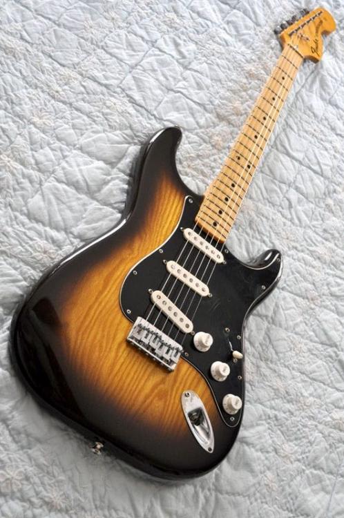

Lockbody Posted January 26, 2023 Posted January 26, 2023 Wow! I just went through this thread, and what can one say that hasn’t already been said? You are truly a master of your craft! Man, I thought I was hot stuff a few years ago when I just refinished a ‘75 Strat! I’m in awe of your skills.
slingblader Posted January 27, 2023 Author Posted January 27, 2023 On 1/26/2023 at 12:08 AM, Kerry Marchman said: Absolutely spectacular work! A joy to see this kind of talent. Well done!!!! On 1/26/2023 at 7:18 AM, Lockbody said: Wow! I just went through this thread, and what can one say that hasn’t already been said? You are truly a master of your craft! Man, I thought I was hot stuff a few years ago when I just refinished a ‘75 Strat! I’m in awe of your skills. Well, thanks a lot to both of you, I appreciate it! Nice job on that Strat!
