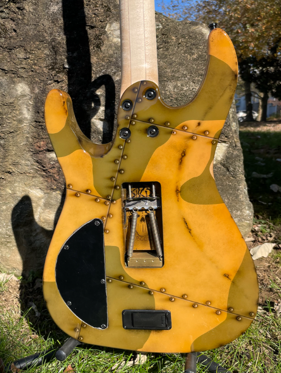

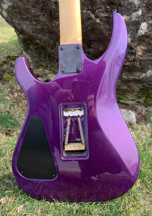

JGale Posted November 19, 2021 Posted November 19, 2021 2 hours ago, gtrdaddy said: Using all five springs greatly improves stability. Use all five. or
