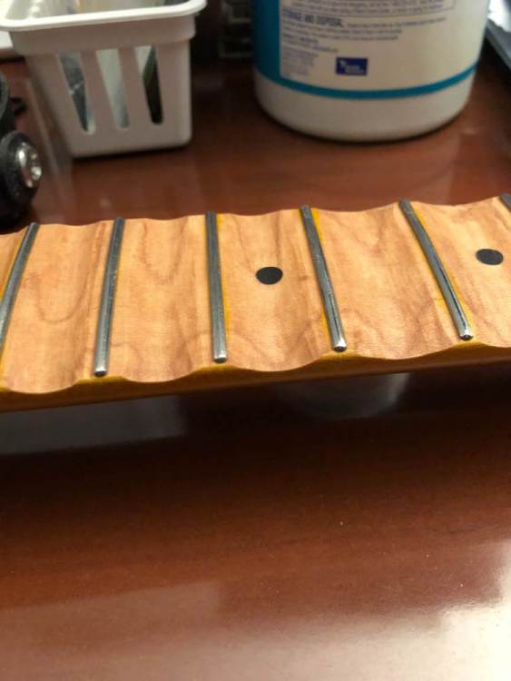

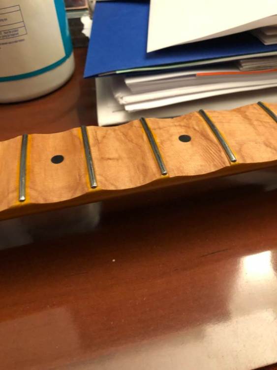

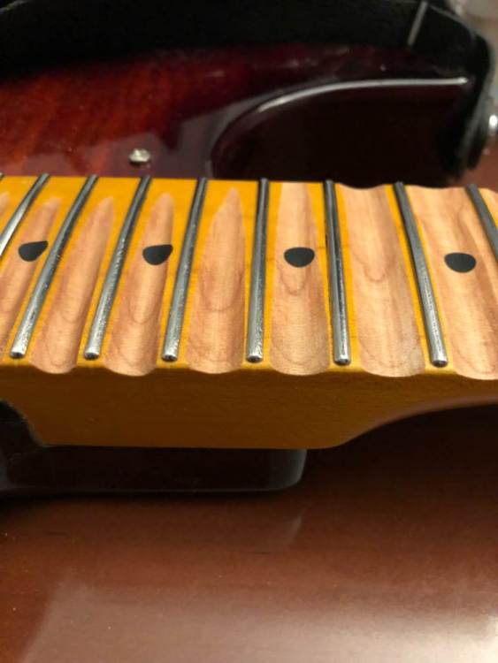

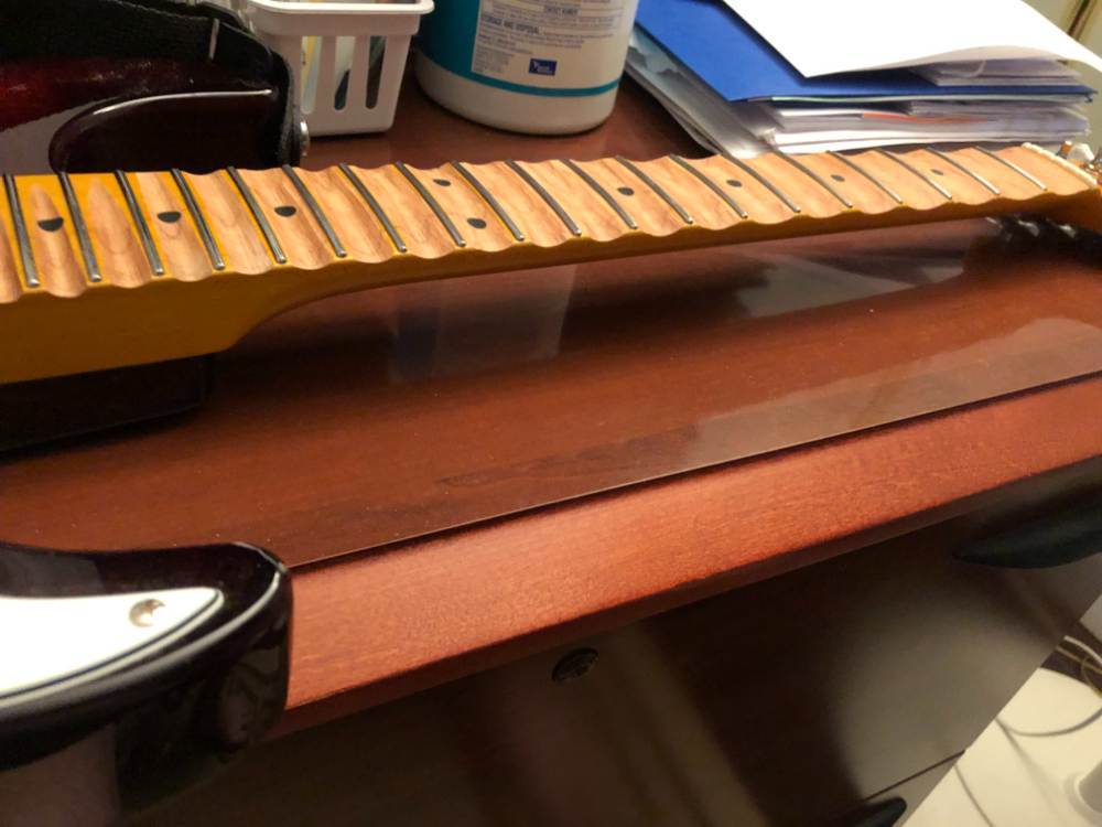

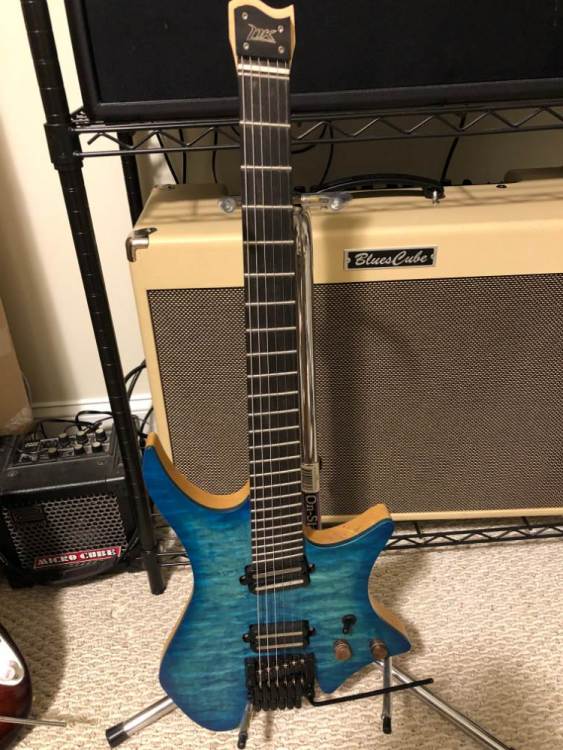

Nathan of Brainfertilizer Fame Posted May 30, 2022 Posted May 30, 2022 It's obviously far from perfect. You can see there are a few ledges and the groove depths are not all even. But it did what it was supposed to do in getting wood out from under my fingers when fretting. The next one I do will be more even, I think. I have 3 more cheap guitars to scallop. But the last one, i expect to have it down pretty well.
Nathan of Brainfertilizer Fame Posted May 30, 2022 Author Posted May 30, 2022 I did it with a combination of different round files and half-round files of different widths and sizes. Used teak oil to season/protect the raw wood.
Nathan of Brainfertilizer Fame Posted May 30, 2022 Author Posted May 30, 2022 16 minutes ago, Steve Haynie said: How has the truss rod adjustment been affected? that's a good question. It actually seems to have affected the trem balance more. I broke an E string trying to get the trem level with the body and the guitar all tuned up. But maybe that would have been resolved with a truss rod tweak. I might try adjusting the truss rod before I try restringing?
Nathan of Brainfertilizer Fame Posted May 30, 2022 Author Posted May 30, 2022 The higher frets not being fully scalloped *was* deliberate, but not sure I like it.
Nathan of Brainfertilizer Fame Posted May 30, 2022 Author Posted May 30, 2022 4 hours ago, Steve Haynie said: How has the truss rod adjustment been affected? The scalloping did apparently result in a slight buzz on the 1st and 2nd frets until I loosened up the truss rod a little.

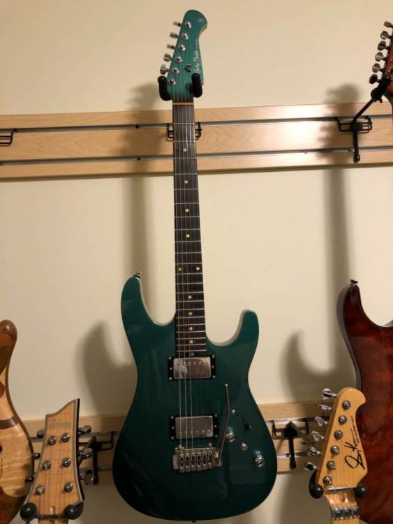

Nathan of Brainfertilizer Fame Posted May 31, 2022 Author Posted May 31, 2022 Which one should I do next? A Harley Benton Fusion II with ebony fretboard and stainless steel frets? Or a no-name Chinese headless guitar with fanned ebony frets and stainless steel frets. I have fully embraced scalloped fretboards with stainless steel frets as my preference. The one picture up above is an EART Corsair with stainless steel frets and an aftermarket (broken) fretboard that I got for $200. The Harley Benton was $300 used from Guitar Center, the Chinese headless was like $450. I have a Yamaha PAC 611 VFM and a Fender Showmaster that I'm considering scalloping, but they have regular frets, so I guess I have to get them refretted before I do it. The Showmaster has 24 frets, and that gets really narrow at 23 and 24...plus, those are both more my favorite guitars, so I want to continue to practice with these cheaper/disposable before I do something I really love.
Nathan of Brainfertilizer Fame Posted June 2, 2022 Author Posted June 2, 2022 I think on the next one, I will not scallop frets 1-4. I usually play with a fairly light hand, but on this one, I seem to push it out of tune on the D major chord way too easily.
