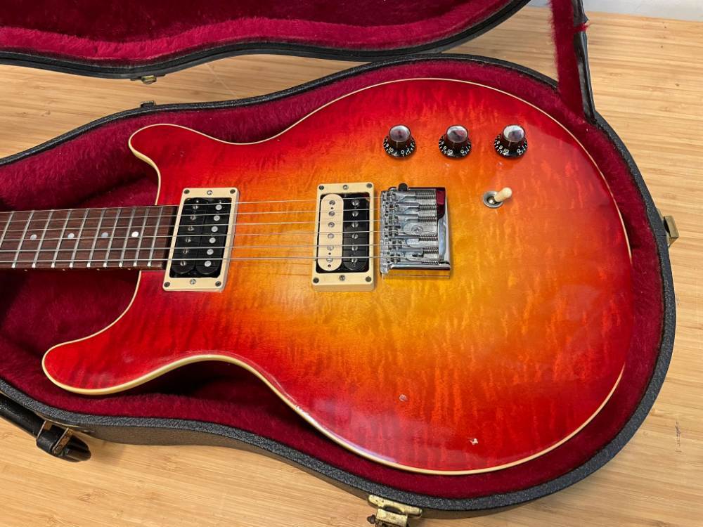

I have a 1978 Hamer Sunburst. Serial number is 8 0432, which corresponds to the 70s, and the pots are 1978. So far so good, but it has a Schaller replacement bridge on it that works but looks terrible. I have bought a replacement from MannMade, but that doesn't fit, it's too narrow.
From what I can gather this is a known issue on the earliest Sunbursts, and looking at early ones the bridge plate does look slightly wider than the one I have from MannMade. Does anyone have one with the right width lying around that I can buy, or any other suggestions for how to get one? The guitar works as it is but just doesn't look right, and we can't have that 😉

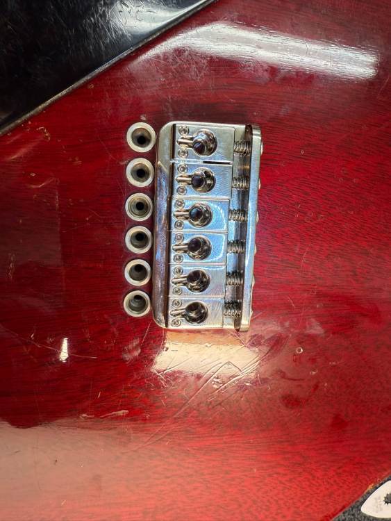

Thanks for all the replies. Sorry about the missing pics, the file size was larger than the board would accept! Here they are redone. The first photo shows the Schaller bridge currently on the guitar, the third one is the MannMade replacement. In the photo it kinda looks like it fits but it very much doesn't.
Sounds like a long shot to get an original or a modern replacement that fits, so it'll have to keep rocking out with the Schaller I guess! 😉

I think the MannMade bridge could fit, but it would require drilling , dowelling and redrilling the holes for the mounting screws (assuming they don't currently line up) plus enlarging string channel openings on the top of the guitar.
Permanent modificiations, but they would be hidden under the bridge plate.
You'd also need to check carefully to make sure the neck angle is within the adjustment range of the bridge saddles.  If not, you could still make it work by shimming or grinding down the base plate.
Note that I've never done this, so check everything carefully before proceeding if you're considering it.

Nope. Last one went on my Shishkov. And the MannMade bridges are really close to what I did, so I think whatever issue being had would be the same. It's kinda hard to tell from the picture exactly what's going on.
Is it spacing? The string spacing is a bit all over the board, depending on where the bridge was made. Not a huge difference between them, but they did vary.
Mounting holes? Dave's fix nailed it.
But if the mounting holes line up, it should work. Put it on and try it. The string-through-the-body holes don't have to align perfectly for the bridge to work. The bridge on my '81 Special had .025" difference (about 1/8" overall) between the string-through holes and the intonation screw holes, effectively mis-aligning the saddles. Worked fine.

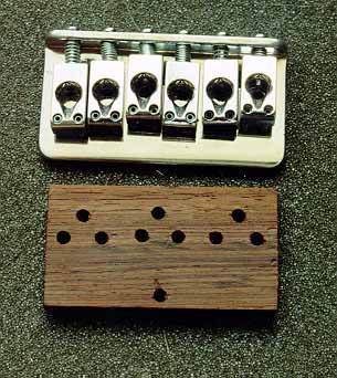

From "The Hamer Fan Club"  (link:  https://www.hamerfanclub.com/494-2/  ) :
The earliest Sunbursts such as the 1978 example shown above have a bridge raised on a rosewood or ebony shim. The spacing of the strings is wider with this style of bridge so the string ferules at the back of the guitar are further apart than on later guitars. The photo below shows an early bridge and wooden-shim.
You may have to go this route. A Strat hardtail bridge plate and shim might get you there (I've never tried it).

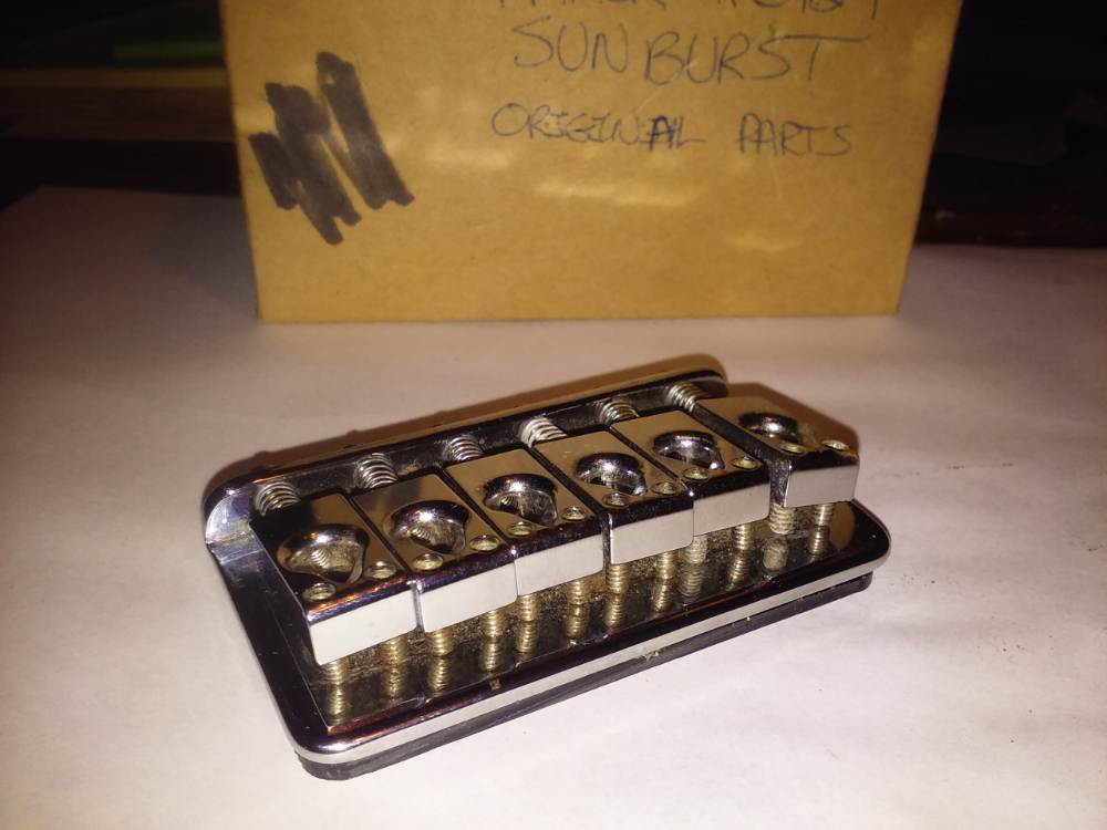

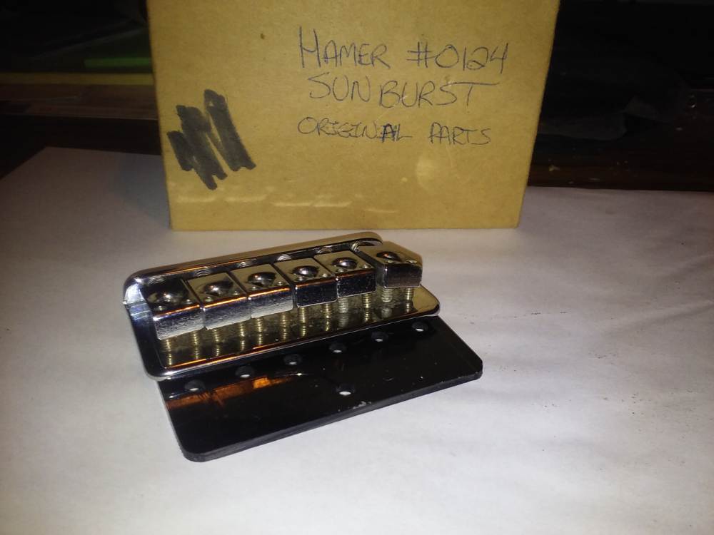

I have one of those. Came from 7 0124. Base plate appears to be pickguard material.
Been in the drawer for years. If you are interested let me know and I'll dig it out and get measurements.
Edited by Hbom
  • Like 6
  • Thanks 1
Wow! That looks literally like exactly what I'm after judging by the clearly wider base plate. Thank you! Measurements would be great, if they match I am super interested. Thanks again!

String spacing is way out so that's a no go unfortunately!

The bridge Hbom has is really your only bet. I probably found the last NOS Bridge 12 or 13 years ago out of the UK. Late 78 is when Hamer went to the SB Bridge, everything else prior to, are what they could buy off the shelf.
do you still have this available?
Sitting on my desk waiting for me to get off my ass and ship it to Denmark.
