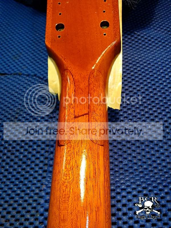

I have had requests to post bench reports again(it has been quite a while since I have done so), so I thought I'd show you this little gem....
This one should be a challenge.
2003 R7 with a Braz board and an unlucky past. The owner claims that it fell down the stairs, but this sort of damage is beyond what a stairwell can do.....
Clamps are my best friends.....
Sanded, ready for lacquer. 8 pieces of mahogany between the heel and tip of the headstock......
Sprayed and drying.....
The dark areas are actually endgrain of mahogany fills in between the splints and the original wood.
We are getting somewhere....
Oh, GEE! I found a pair of nasty old warped 50's PAFs in a box under the bench. What SHALL I do with them?
The finished neck repair as the tuners are installed.
Did I mention that it's 8.5 lbs?

A 3 piece neck would have put up more of a fight. As to whether I could fix it?
I CAN FIX ANY GUITAR!!!!!
So here it was upon reassembly...
Some recent pics, sporting GregWinds and some checking to make it look less like it was stomped in high heels and more like a vintage goldtop that has seen some use....
This guitar is now a permanent member of my stage arsenal, and it FEELS like my vintage Pauls. I didn't think I could fix it, so we are all impressed at this one!
