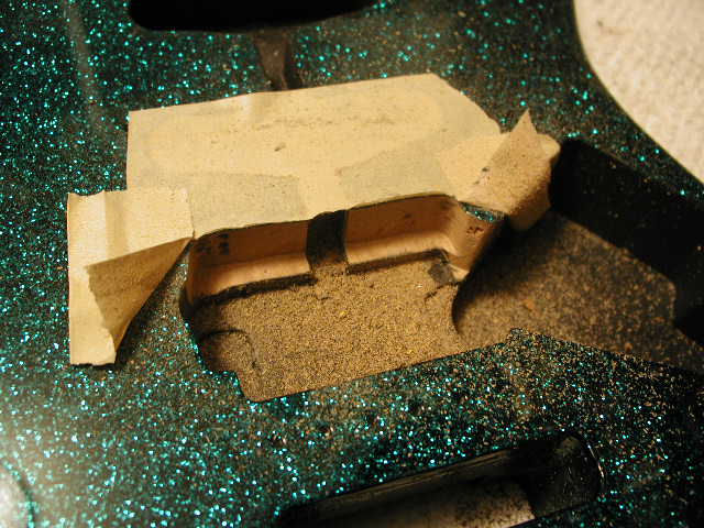

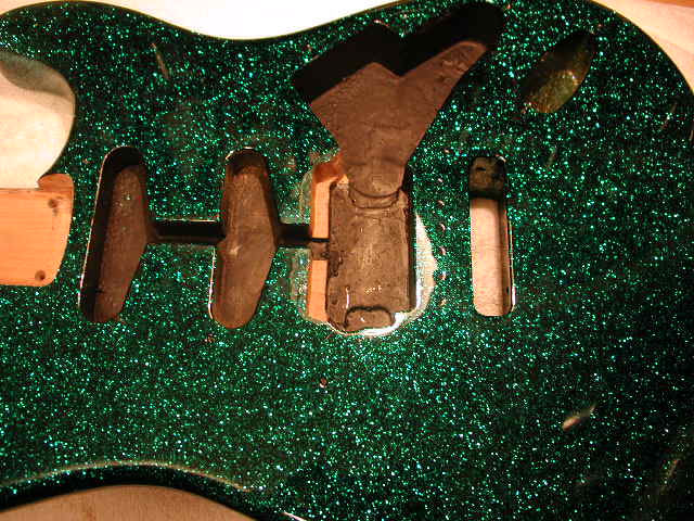

First, I had to remove some wood from the cavity so the bridge humbucker would fit. I don't own a router, so I did the best I could with my Dremel tool:
Not too bad, and definitely an improvement from when I did this type of mod with a chisel.

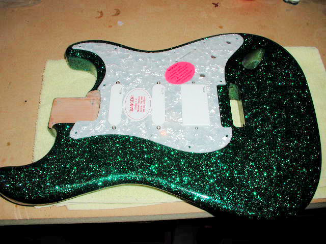

Test fitting the pickguard and pickups:
Yup, it fits!
BTW, this body is tough to photograph. It looks much better in person. Stike is THE MAN!

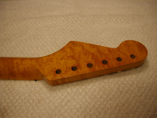

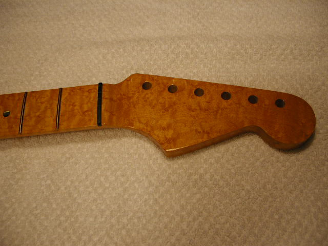

The neck:
Verrrry nassss.
I've got something in the works that'll have Stike ROWYCO Kustoms written all over it-flake and pearloid. Mmmm good!
Dave-this looks completely badassed and you are so correct-Stike rocks a finish!
i stopped by stikes shop earlier this week, he has some killer lookin stuff in the works. thanx bro for the free GFS pups.
I love the neck. Things like this are rarely seen.
What kind of wood is it made from?
Birdseye maple with a vintage tint finish.

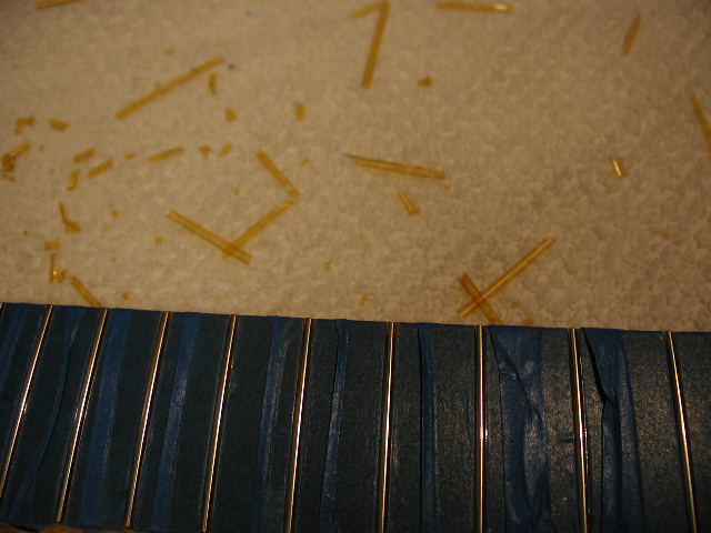

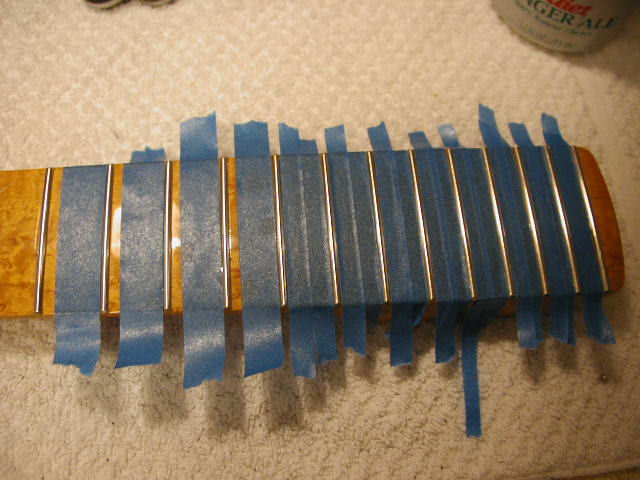

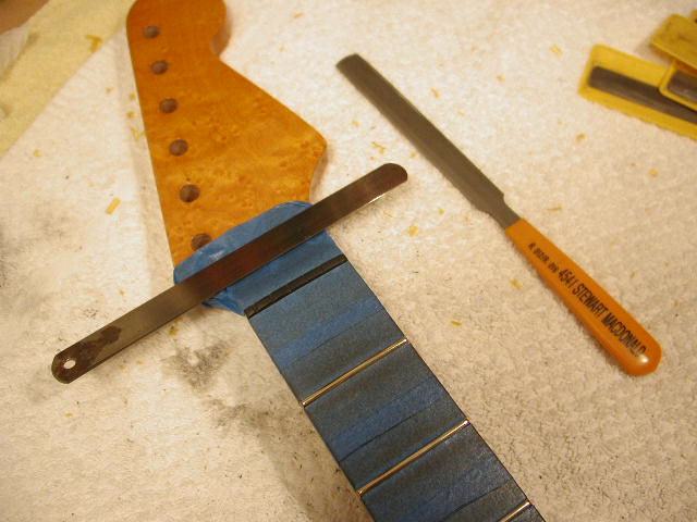

Prepping the neck to remove lacquer from the frets:

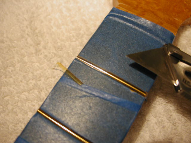

Scoring and removing the lacquer:

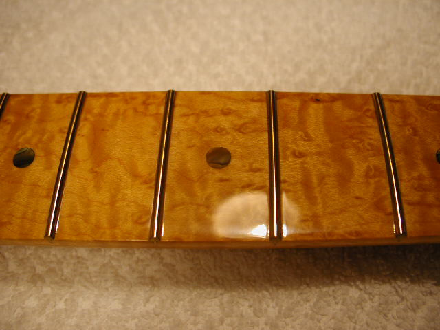

Clean frets!

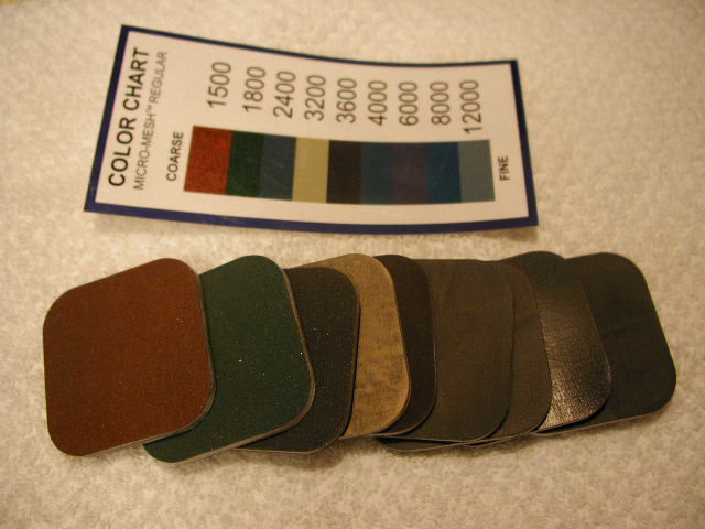

This is what I use to dress and polish frets:
After a couple of hours of fret polishing, I'm ready to adjust the nut slots. This neck came with a pre-slotted graphite nut, but you still have to make the slots the right depth and width.

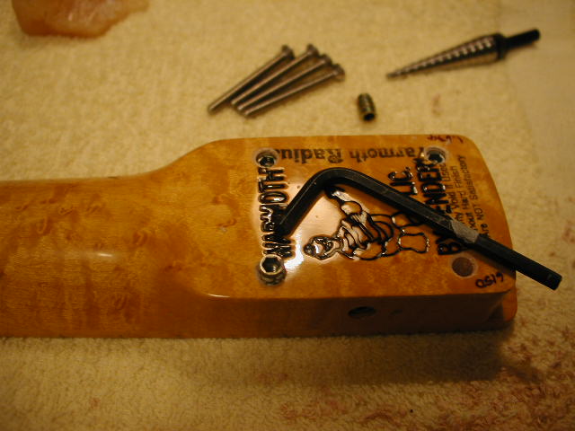

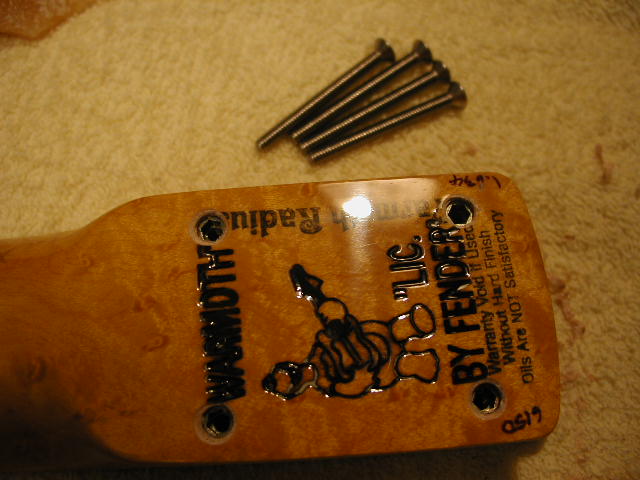

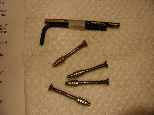

I'm waiting for the bridge assembly to arrive, so I thought I'd try out these cool neck inserts from Roy Bullis:
These are a less complicated version of the Tele kits that Jay Monterose (sp?) used to sell at Vintique. They include a double threaded insert that goes into the neck. Once that's done you can mount the neck using machine screws, rather than wood screws. Les risk of stripping out the holes and also allows you to crank down the screws for a tighter fit.

They include a double threaded insert that goes into the neck. Once that's done you can mount the neck using machine screws, rather than wood screws. Less risk of stripping out the holes and also allows you to crank down the screws for a tighter fit.
That's cool, Dave. I've had these installed in my YJM strat and Charvel SoCal (and a MexiTele known as "The Money Pit", since sold). They're especially nice for the SoCal, as it has a vintage trussrod adjustment, requiring neck removal. These allow for a very sturdy bond between neck/body, as stated previously.

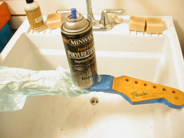

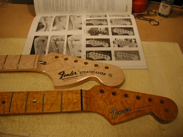

Adding some headstock decals:

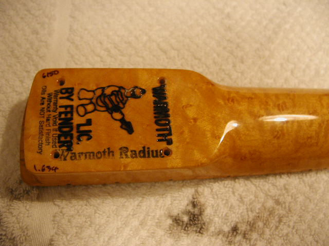

And on the back:
Next, several coats of clear polyurethane over the decals and more sanding . . .
