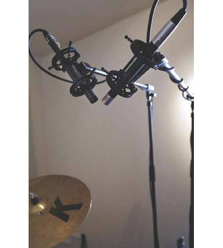

MrGuitarguy Posted November 30, 2009 Posted November 30, 2009 I just lectured 200 students at a local university about this stuff the other day... (disclaimer: I found these images online. I don't have a drum set in today since I'm mixing or I would have snapped some photos of my own) Personally, I wouldn't recommend a 57 for a kick drum. You're simply not going to get much low end. My favorite dynamic kick mic the EV 868, but the D112 or other standards from shure and sennheiser will do the trick too. Put a he in your kick drum and place the mic about 2 inches inside. The Aquarian super kick heads (the ones with the foam ring attached to them) are my favorite for a tight kick sound. Boost 1-2kHz for snap, 3-4kHz for bite and 5-7kHz for click (like a speed metal style drum sound) Mic your snare by pointing the mic at the top head where the drummer strikes the drum most (usually indicated by the marks on the head). Keep the mic about 3-6 inches above the drum. Aim from under the hi-hat to eliminate bleed (using a cardioid mic like a SM57). An SM57 is idea for this (the industry standard for snare miking) but a small diaphragm condenser works great for more snap. For toms, SM57's will work great. Point the at the center of the toms about 3-4 inches above the drum. For overheads I prefer a spaced pair for width, especially if tom mic aren't used. However, phase is more of a concern in this type of technique, but I greatly prefer the sound. Make sure you've over the whole kit with a spaced pair, but try to center things on the snare. The x/y technique is basically idiot proof when it comes to phase concerns between the two overheads, but lacks a lot of width. I would recommend two condenser mics for overheads, however you do it, especially if you don't have tom mics, but SM57's can get the job done. Be sure to get the overheads high enough that you get rid of the rumble on any heavy cymbals and be sure you have the hi-hat in thee too if you don't have a mic on it. Odds are you'll need to flip the phase on your overheads. The mud in your overheads will probably be around 400Hz A wide Q on the eq when reducing it should help suck some of it down. x/y method: Spaced pair: Don't be shy with compression on your drums. Especially on the overheads if you don't have tom mics. High overheads like in the spaced pair picture, would be best for a 4 mic setup IMHO. In fact, the spaced pair picture is exactly the 4 mic setup I'd use. The first Boston album used this setup. To check the phase of any two mics you can put your speakers in mono and flip phase one mic and try to get the sound to disappear as much as possible (it will get really thin sounding). Then flip the phase back on the mic you flipped previously and things should sound really thick, which is what you want. In stereo, like on two overheads, the phase will sound like it's starting to come from further outside the speakers (almost a 3d effect) if it's wrong. Odds are your recording software also has a phase correlation meter built in that can help too. Another easy way to check phase is to record a little bit of the drums and then zoom in on the waveforms. The waveforms shoul g up and down together, if they're opposite, then they are out of phase. Keep in mid that the will never be perfect as the distance to each mic will effect when the waves start and stop, but they should be close. Out of phase waveforms that are shown canceling each other out (bottom waveform): Hope this helps. Post if you need help on any more miking, mixing, etc.
