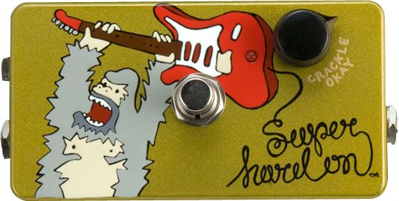

What did it do before it died? I know certain fuzz configurations crackle when the gain knob is moved because of the DC across the pot. My Lovepedal BBB is that way. Some of the ZVEX pedals even have "Crackle Okay" on the knob:
