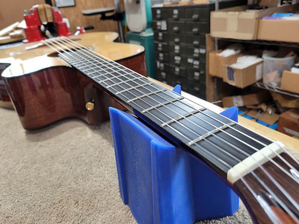

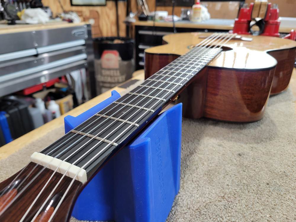

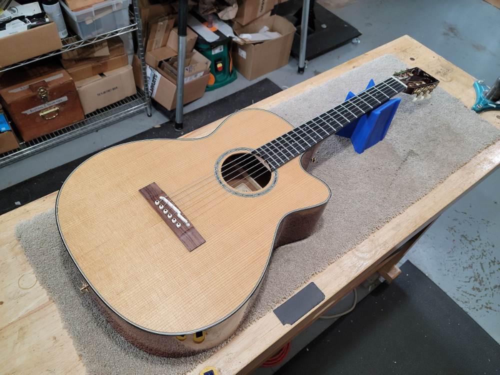

Jeff R Posted October 20, 2023 Posted October 20, 2023 I don't overbend and try to match radius with SS, even when I glue in frets. On that note, I always glue in frets now whether NS or SS, and that's after experimenting over time with multiple reps of both glue and non-glue approaches on various fingerboards. If you want DIY tips, you gotta be more specific. There are literally dozens of tasks, techniques and tool choices associated with fretwork. The most fundamental tips I'd offer would be to tool up properly and put in dozens of reps on guitars that don't matter before you take on guitars that do matter. You learn or apply something new EVERY refret job. At least I do. And watch every pro video you can put your eyes on and look for the common denominators among the pros, whether it's tool selection, fret selection, removing frets, FB and slot prep, fretwire prep, installation techniques, bevel and end dress, LCP, etc. I'd start with the DIY fretwork playlist on StewMac's YouTube channel. Since we like eye candy, here's my most recent refret. A slot head steel string Tak owned by an 85-year old gentleman in NC. He is losing hand strength due to age and asked for a refret with NS 57110s (second-largest common jumbo), conversion to nylons and super low action.

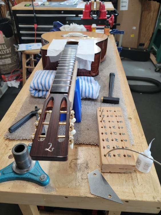

Jeff R Posted October 21, 2023 Posted October 21, 2023 CA glue is released very easily with heat, zero issues. I usually install via arbor press. Three small dots of 30 weight gel CA on the tang and then I wick the installed fret with 10 weight water-thin CA. If I'm installing frets with a brass head hammer (F15 and up on a traditional acoustic for example), I only wick in the 10 weight CA. Even 30 weight gel can and will splatter from a hammer hit. On that note, to protect the FB from glue where it doesn't belong, you put a layer of paste wax on the surface prior to fret installation. After installation, I remove any glue seep or squeeze-out and the wax with acetone on a cloth. DO NOT get ANY acetone on modern plastic inlays or dots! Be sure to re-oil after acetone treatment in the case of FB woods other than maple. Here's the above guitar during the refret. I had finished pressing the trunk register and had moved to hammering in the body register. You can see the sheen of the paste wax on the fingerboard and the water-thin CA, it's the bottle with the whip tip applicator.
