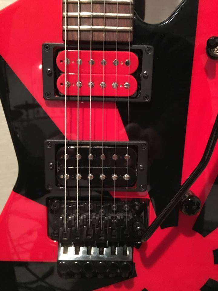

diablo175 Posted March 7, 2016 Author Posted March 7, 2016 Pick up swap complete and despite missing positively charged ionic framistat tape inductor whatchamacallits, the Alt 8 works perfectly fine. Mighty fine job of installing those, if I do say so myself- i.e. I didn't burn down the work area and I didn't melt anything into useless slag. Actually, the Alt 8 /'59 combo sounds pretty good- think a souped up JB and, well, a '59. Aside from the minor screw up of reversing the connection leads from the toggle switch- bridge was neck and neck was bridge, everything worked out nicely. Next up: the Kraken Cali gets it's total overhaul! <cue dramatic music>
gorch Posted March 8, 2016 Posted March 8, 2016 The pickups don't match the body paint signature. Attention to detail please.
