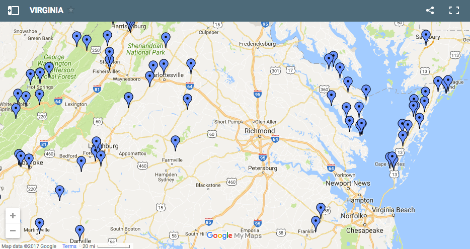

On 5/31/2017 at 9:11 PM, cynic said:
Google ethanol free gas stations in your area. Some stations have an etoh-free option but they charge through the nose for it. Stations that only sell etoh free typically offer more reasonable prices. John Deere says 89 octane is better as well. I use 89 oct etoh-free in all my lawn equipment and also add Sta-Bil to every can. It might be overkill but i never "winterize" and after 4-5 months of nonuse everything starts in the Spring like I used it last week.
I went to several sites that are supposed to show you where the ethanol-free gas stations are in your area, but none work by ZIP code so that was frustrating.  I couldn't find a single ethanol-free gas station listed within 50 miles - crazy!  I live just outside Richmond and I feel like there HAS to be one somewhere around.  I posted to a local community FB group asking if anyone knew of a place with ethanol-free gas but so far no responses.  I'll use the additive I found until I can locate a gas station.

On 6/1/2017 at 0:28 PM, cynic said:
You're right.  Richmond looks pretty ethanolized.
Thanks, Dick Gephardt!  :mellow:  (was that too political?)
