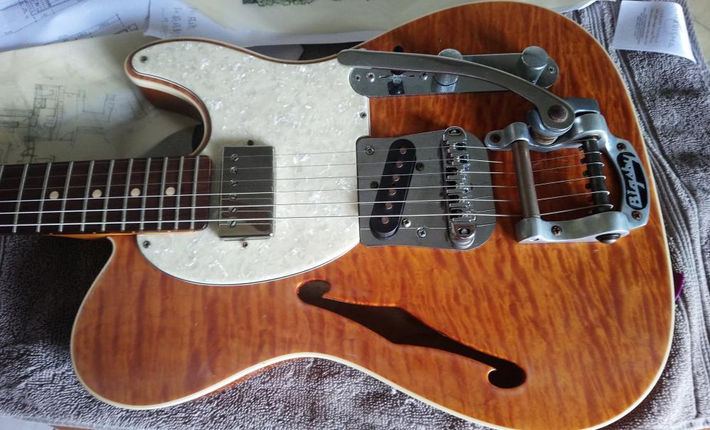

jaberwock Posted September 7, 2017 Author Posted September 7, 2017 9 hours ago, murkat said: string guide with added weight. you can make the same thing at ace hardware for about 1/2 hour of your time and 5 bucks. If I had access to a lathe I'd try making one for sure; but if I can rescue my Thin line Tele from the thin weak tone it has at present for 45 bucks, I'll give that a go. Here's what Charles Guitars had to say about the mod: All guitars equipped with a Bigsby B5 or B7 Vibrato suffer greatly because the front roller is made from hollow tube and so gives a very thin tone with little depth, resonance and sustain. Callaham's upgrade kits provides a solid, stainless steel front roller and axle that will widen the frequency response and sustain to where it should have always been. The roller is polished to a mirror finish and is grooved to maintain string alignment. This is a simple retrofit and pays huge dividends. We say: We have fitted these and the difference is remarkalble, Bigsby's have always had a reputation of providing a Vintage look but thin sound....well not anymore with this upgrade the tone is thicker and fatter.

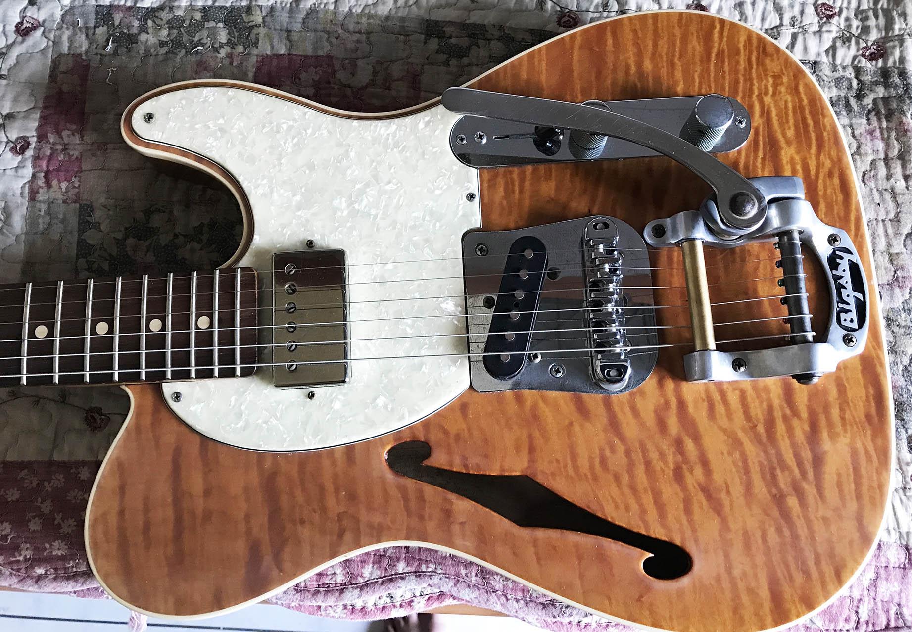

jaberwock Posted September 25, 2017 Author Posted September 25, 2017 I found some copper pipe that with a little sanding, was a nice tight push fit inside the front roller, added around 30% to the weight, and really reduced the "tinny " sound when tapped; adding some silicon grease to the two brass "bearings" made a big improvement to tuning stablity, and freed up the Bigsby movement. A brass GFS roller bridge increased sustain, and fullness, over the Schaller it replaced, this plus the Bigsby overhaul turned this guitar from one I was thinking of selling to a regular player for around thirty five bucks !! Jaberwock

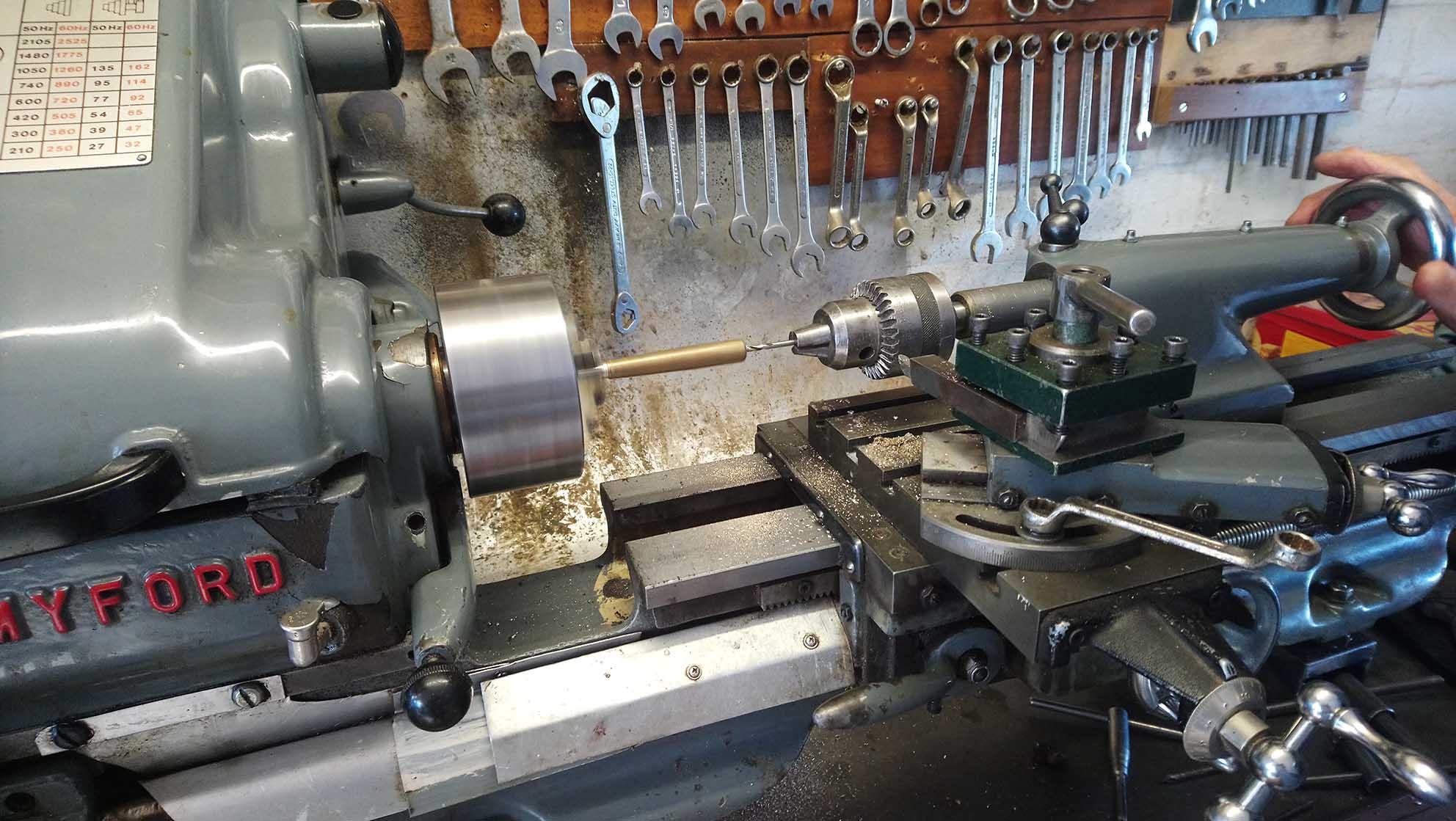

jaberwock Posted June 16, 2018 Author Posted June 16, 2018 I made a brass roller for my Bigsby on my friends lathe while I was back in the UK, unwound strings especially sound fuller and sweeter, finally got rid of the thin nasal tone that plagued that guitar. Jaberwock
