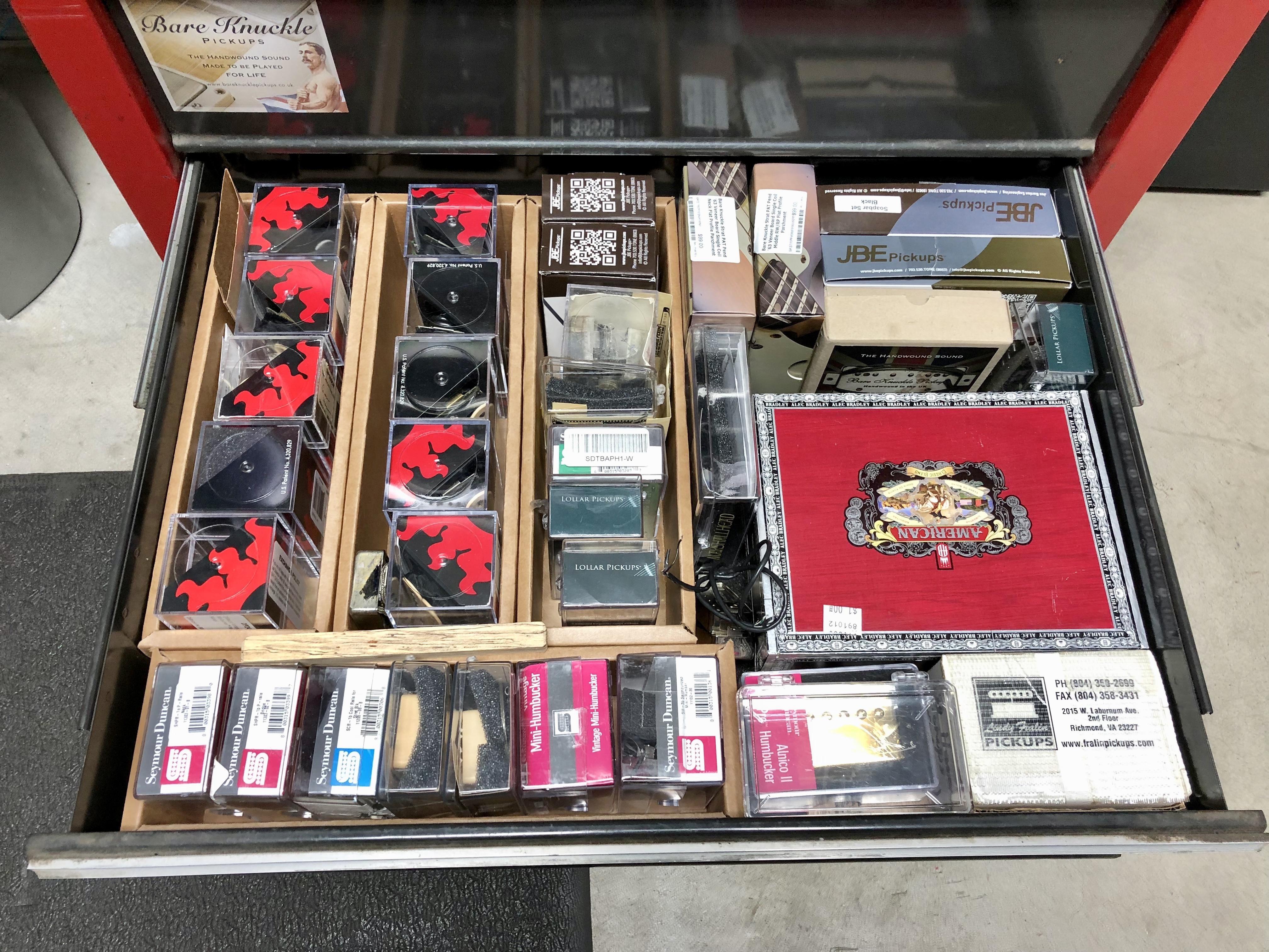

tomteriffic Posted January 23, 2019 Posted January 23, 2019 I keep mine either in plastic (Duncan) boxes or wrapped in tissue paper in a cardboard box. They're all in a wire basket/bin, nothing gets any closer than about 1/4" to any metal. No problems that I'm aware of. HOWEVER: Most Esteemed Redhead is under orders to move or put away any guitars I may have out on stands if there's going to be a vacuum cleaner running anywhere near there. I'm under the same orders. Don't ask me how I know. It's too painful.
