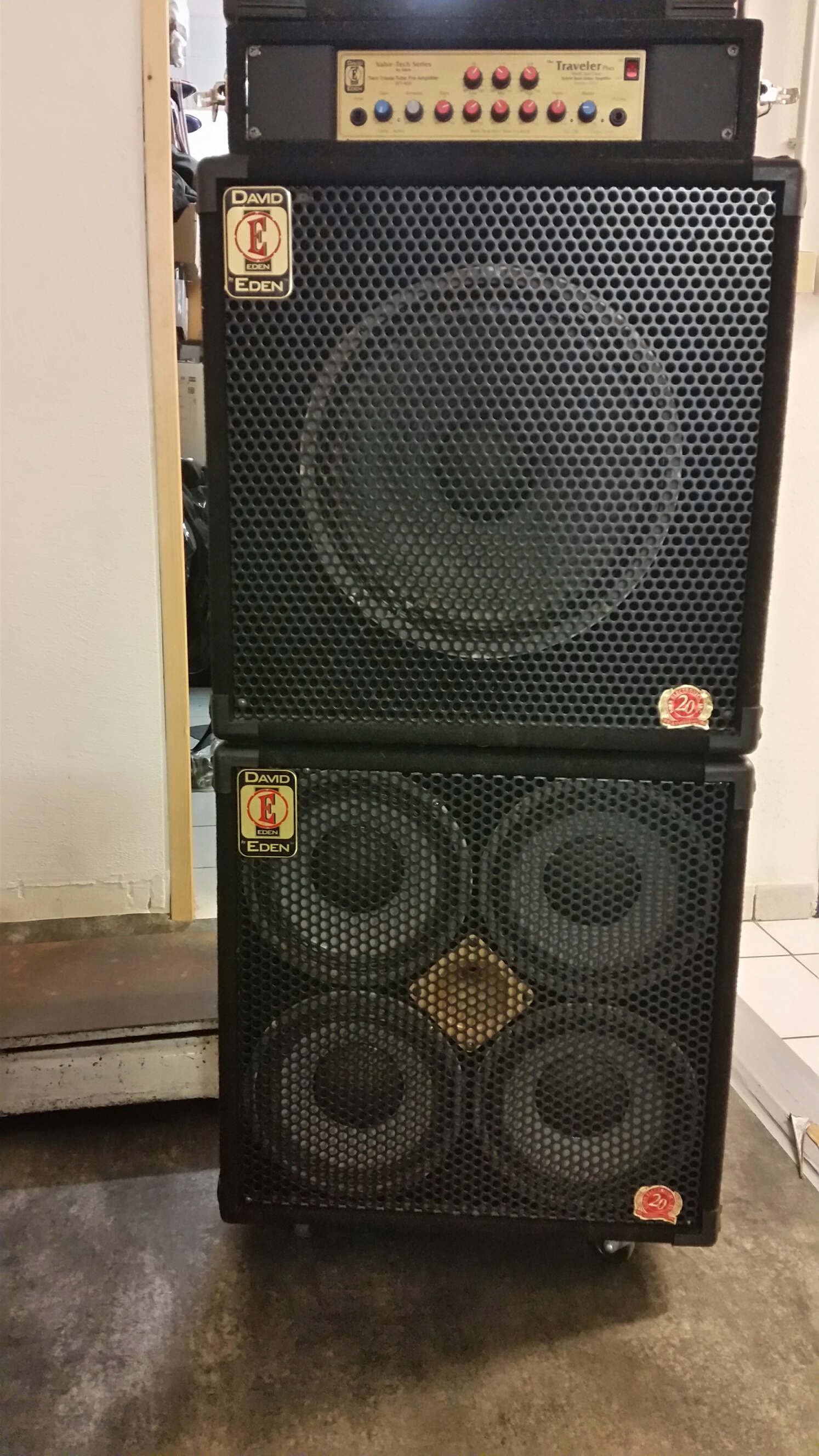

My favorite bass rig was the Eden.
Although I've never seen anyone put the 15" on top before, only pic I could find.
