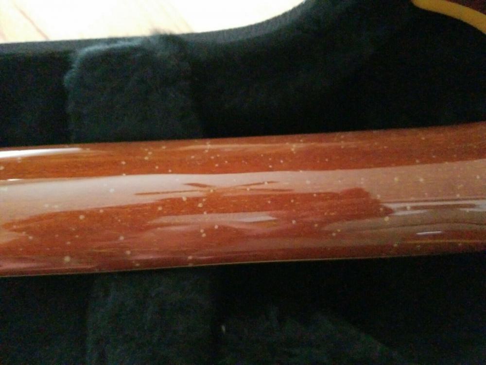

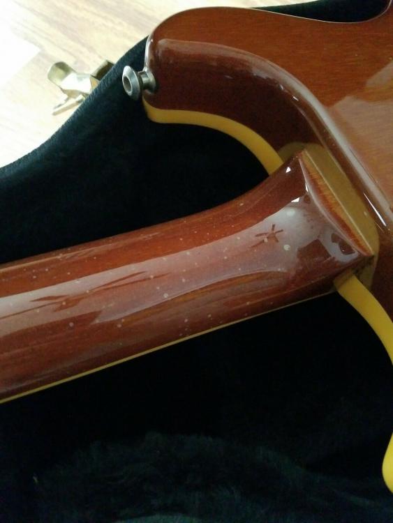

coffeeroastee Posted October 24, 2019 Posted October 24, 2019 so i won an auction of a hamer studio custom...plays ok sounds great...thing is theres bubbles in the neck finish that are rough to the touch...its distracting...should I steel wool the neck? any ideas?

tbonesullivan Posted October 25, 2019 Posted October 25, 2019 That looks like someone shook off a paint brush near the neck. Are you sure it's the finish lifting, and not something on the finish?
Dave Scepter Posted October 26, 2019 Posted October 26, 2019 7 hours ago, tbonesullivan said: That looks like someone shook off a paint brush near the neck... Shook off something! 😆 Seriously though, if you love the guitar and the way it sounds and plays, and plan on keeping it, there's nothing stopping you from taking some steel wool to the back of it... it's not as though it's some rare 59 Les Paul or anyting... you'll probably get the same amount selling it in either condition... and this way you get to play it until you get sick of it

Steve Haynie Posted October 26, 2019 Posted October 26, 2019 That is some serious Hameritis around the neck joint. Finish lifting was a problem for a brief time, but it never caused a problem with feeling rough. So, can you feel anything around the neck joint? There might be two different things going on with your finish.
coffeeroastee Posted October 26, 2019 Author Posted October 26, 2019 Hi Steve, the finish is smooth around the neck joint, just rough on the neck
coffeeroastee Posted October 26, 2019 Author Posted October 26, 2019 16 hours ago, tbonesullivan said: That looks like someone shook off a paint brush near the neck. Are you sure it's the finish lifting, and not something on the finish? yea its just the finish

gtrdaddy Posted October 26, 2019 Posted October 26, 2019 Seriously though, refinishing is probably the only option. Those are most likely air bubbles, the result of moisture that remained in the wood at the time the clear coat was applied, or possibly from abnormal drying of the clear coat.

coffeeroastee Posted October 26, 2019 Author Posted October 26, 2019 they said bubbles in the clear coat ..it just feels rough and im not sure whether to steel wool or not dont want to ruin it

Dave Scepter Posted October 26, 2019 Posted October 26, 2019 38 minutes ago, coffeeroastee said: they said bubbles in the clear coat ..it just feels rough and im not sure whether to steel wool or not dont want to ruin it If you use steel wool, make sure you cover the pickup areas with newspapers/rag/masking tape so the magnets in the pickups do not attract the steel wool fibers... if you use sandpaper, use 400 and sand lightly... Either way, you should mask off/ protect the headstock, binding & heel joint area from accidental sanding mishaps
gtrdaddy Posted October 26, 2019 Posted October 26, 2019 Yes! +1 @Dave Scepter Mask those pickups or you’ll never get the tiny metal pieces off your poles. Don't be surprised if you find yourself having to go down to the wood, The bubbles are under the surface, not on it. If you’re not in love with the guitar, if you can send it back, I would! If you like it, I’d send it to @Stike to refinish the neck.
Dutchman Posted October 27, 2019 Posted October 27, 2019 On 10/25/2019 at 5:53 PM, tbonesullivan said: That looks like someone shook off a paint brush near the neck. Are you sure it's the finish lifting, and not something on the finish? I’d guess something got spattered on the wood while it was naked and soaked in... not sure what it might of been a soda explosion or even water. Wood that has it’s pores open and gets drops of water on it doesn’t take stain or finish the same... Sand the neck down and play the shit outa it... I like a sanded/unfinished neck. They feel smooth and fast!! Finish sanding it with 1500 or 2000 grit sandpaper. You will be amazed at how nonsticky and smooth it is!!
tbonesullivan Posted October 27, 2019 Posted October 27, 2019 21 hours ago, Dutchman said: I’d guess something got spattered on the wood while it was naked and soaked in... not sure what it might of been a soda explosion or even water. Wood that has it’s pores open and gets drops of water on it doesn’t take stain or finish the same... Sand the neck down and play the shit outa it... I like a sanded/unfinished neck. They feel smooth and fast!! Finish sanding it with 1500 or 2000 grit sandpaper. You will be amazed at how nonsticky and smooth it is!! That is just weird. The only thing like that I have seen is nitro reacting to insect repellent. To make the finish rough it would have had to been reacting with it after they buffed it out. Just weird. When I see a weird mark on the finish that polish doesn't take off, I go after it with Swirl Remover from Stew Mac. You'd be amazed what it can take right off that usual stuff doesn't. Paint marks, scuffs with plastic, etc.
