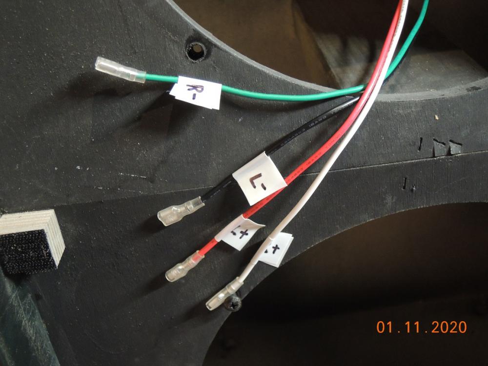

One thing that would have been handy is having the 4 wires labelled L+, L-, R+ and R-. I printed the diagram out in black and white, so it wasn't much help. D'oh!
I did this for future reference (when the instructions are long gone):
So if you install one of these, do your future self a favor.
And no - I'm not done yet. Dammit. One of my donor speakers is 16 ohm. So much for my 10 minute project...

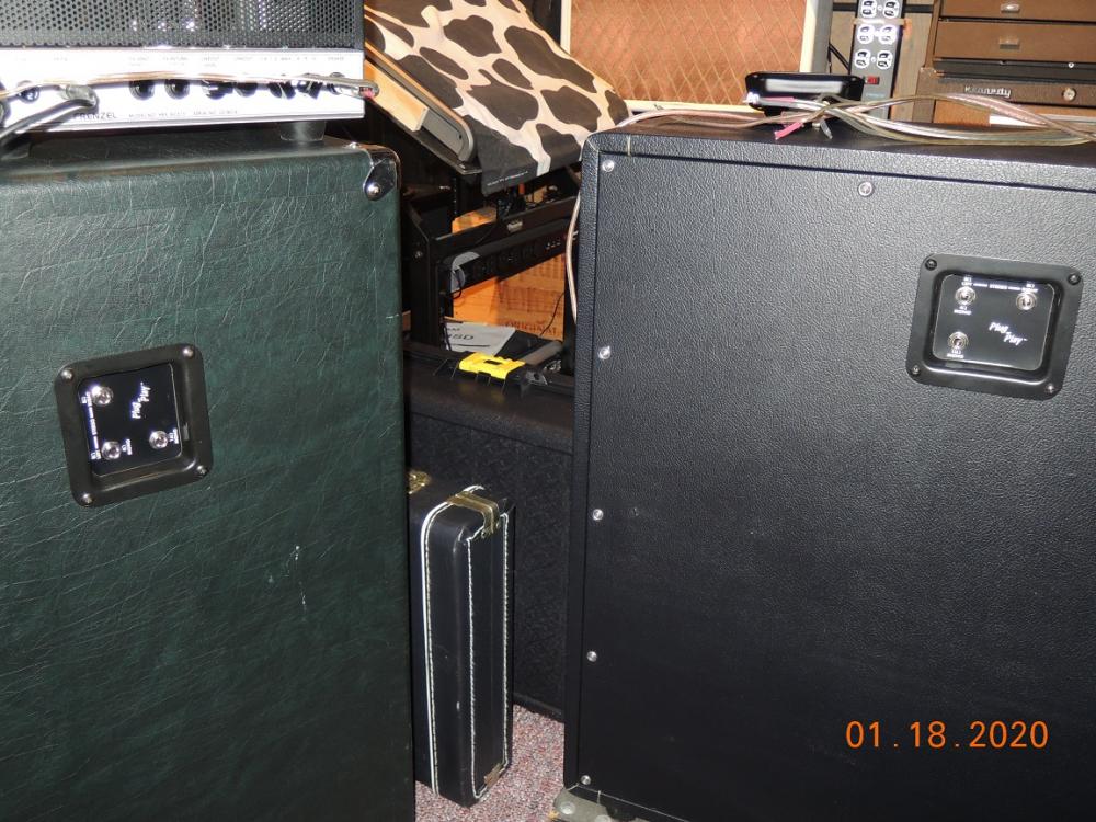

Yeah, finally got mine in yesterday.
The Lopoline cabinet (on the left) had the square hole already in it, just turned the wrong way. It looks crooked AF in this picture, but it's really in there straight. About a 5 minute job. Plus, being sideways like that makes it easier to tell that the top speaker is the right channel and the bottom is left. B)
The Mojotone (right) had just a small single round jack hole, which leads to my first bitch: No template. The 'Plug and Play' people could have made the installation go a lot smoother with a simple template. Instead, it was break out the speed square and grease pencil and try not to mess up an otherwise really clean cab. It worked out better than my typical DIYs, but leads to the second bitch: No screws. After a 1/2 hour of carefully butchering a hole in there, I had to scrounge up screws to mount it. WTFF? They could at least provide screws.
So, I give them 5 stars for the product (very well-made and works excellent, should be in every cabinet with more than 1 speaker), and 1-star on completeness. Because I'm a whiner.
I want to thank Hbom once again for the heads-up on a 'duh, why didn't I think of that' product. Everyone should go buy one (or 2).
