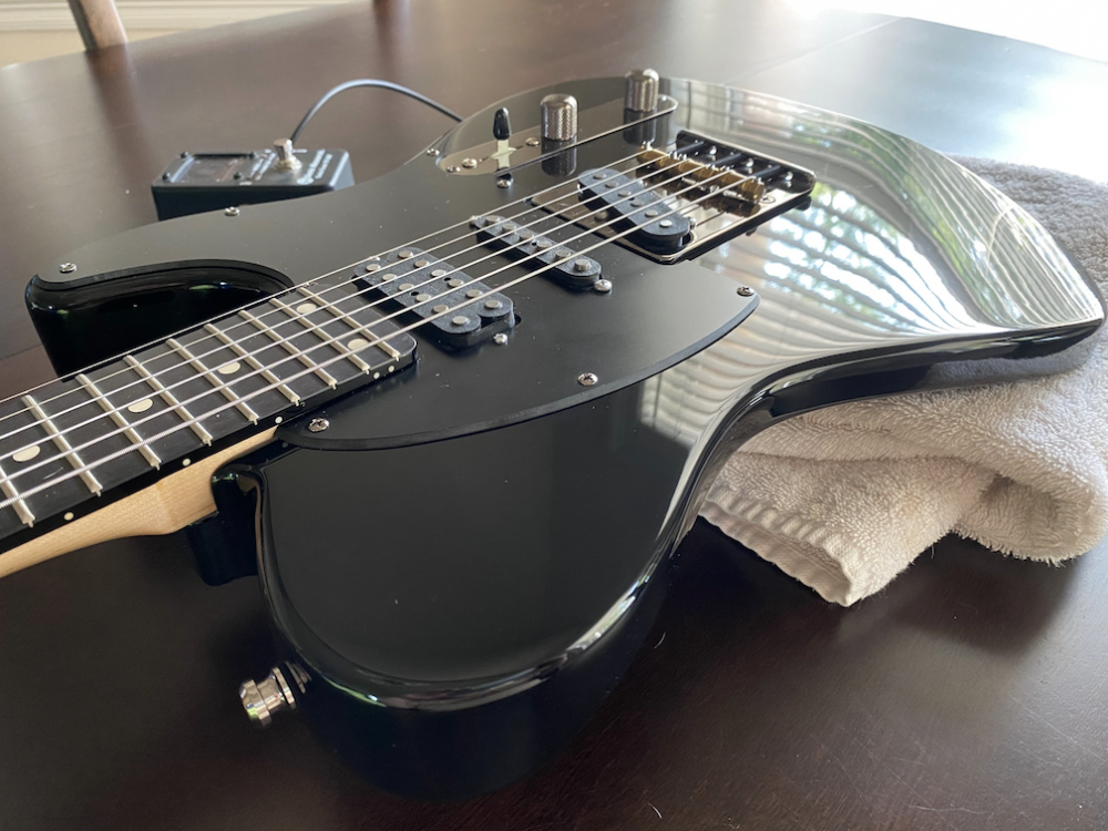

cynic Posted April 9, 2020 Posted April 9, 2020 I just wrapped up this one this morning, getting the string trees and strap buttons on. As @Steve Haynie pointed out, the Warmoth necks just bolt on to whatever you've got for instant baritone. I still need a proper tele-style switch knob, but other than that the looks are as I wanted. I haven't made any adjustments yet so a good top to bottom setup is still needed. The problem. It hadn't occurred to me until I was gathering tools for the setup that trying to intonate a three-barrel bridge on a 28 5/8" scale guitar will make anyone a pussy. Google says it can potentially be achieved through moving saddles around to different positions and/or turning them upside down to negate any built in "compensation". Cynic says just go with individual saddles.
cynic Posted April 11, 2020 Posted April 11, 2020 Another thought on building one...I tend to jump in and make changes as needed as I go. Figuring a baritone would need different gauge strings, I grabbed a pack of the EB Slinky baritone strings and checked the box. It includes a .072 top string. If you get it through the ferrule without modification, you will NOT have the same luck with the tuner. This may have contributed to my intonation issues since my string gauges ended up a little hodge-podge. Even using a Warmoth neck and body, I'll need to shim the neck if I can make the 3-barrel bridge work. Saddle height is a problem even at the lowest settings.

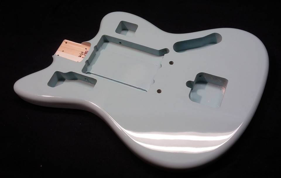

cmatthes Posted April 11, 2020 Posted April 11, 2020 I've been working on one on-and-off for a few years (a Sonic Blue Jaguar/gold hardware and 3 FilterTrons)...great project, it'll be cool when it's done, but it's taken a back seat to a ton of other projects and, well...life. Stike has also been working on one for me, which will be even more unique than the one above. My son has a Baritone Jazzmaster that's a blast to play.
killerteddybear Posted April 11, 2020 Posted April 11, 2020 i did a Warmoth neck on a Mexican Nashville Tele with a Fishman bridge. Worked out well!
cmatthes Posted April 12, 2020 Posted April 12, 2020 This is mine - a SPECTACULAR neck from D. Kunkle with a super dark rosewood slab and '60s-style headstock. Got the body done in Sonic Blue to match the headstock, just need to get off my @$$ and put it together...
