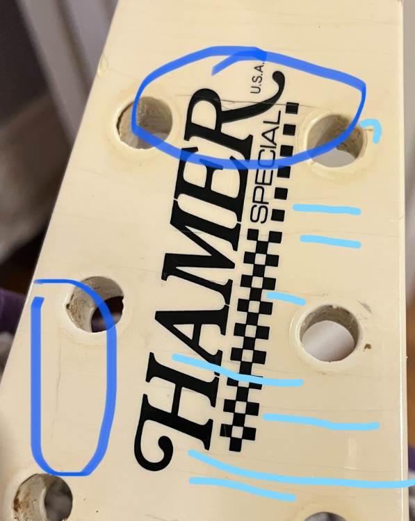

Can (should) I do anything to maintain the finish on this 82 headstock?
bry4321
I am scared to clean or even look at this for fear I will screw it up (although I did muster the courage to take out the tuning pegs to replace chrome w/black and avoided disaster so far).
My biggest concern is whether the horizontal and vertical lines I circled may get worse. Not visually worse, but start to flake off or something along those lines, especially if I bump the headstock etc. You may be able to see additional checking/lines, including around the logo, and I wanted ask the HFC experts if there is anything I can or should do to prevent deterioration/flaking/etc. Like, drop in some clear CA glue or lacquer or something along those lines. Or should I just roll with it.
EDIT: On closer look these aren't as bad as I thought.

If it where mine I'd leave it as is. Just my 72 cents (inflation)
I‘d get rid of these blue circles. Other than that it looks fine to me.
My 76 cents (continued inflation).
Hard to see on my screen but it looks like that's just the beginning of aging paint.
I think I see several more that will be growing in the near future, so you'll be chasing cracks forever once you get started.

Best advice I can offer is to forget about it. Play the hell out of it and enjoy the fact that you are lucky to have found it.
They didn't make many, and they don't make any, anymore.

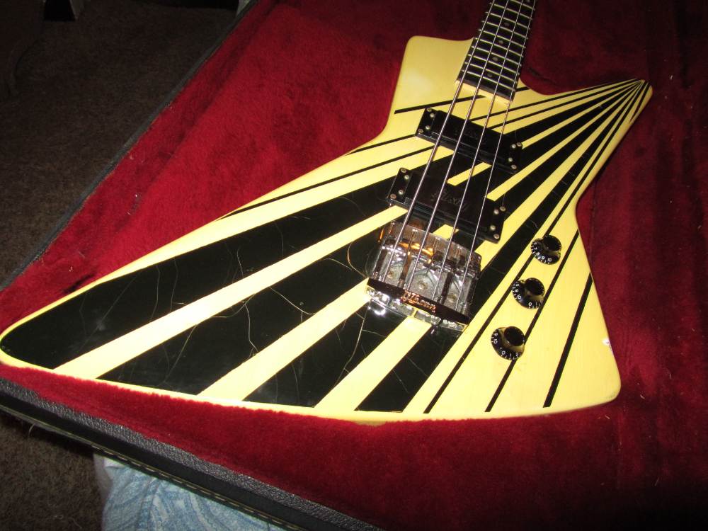

                                It is what it IS as they say......................call it "PATINA" and every guitar gets some of it sometime in its life if you play it. I don't believe you have anything to worry about..................play your guitar and enjoy it. Here is my 1979 B&C'd Black Hamer "SUNBURST" and it had a ton of wear and tear and finish checking, NONE ever fell off.j2yzoC6.jpgkdo5Xb2.jpgbXbLmJ2.jpglGscqn6.jpg

IF the guitar has a nitro finish AND you've cleaned off wax and oils thoroughly using naptha (aka white gas, aka Ronson lighter fluid, aka Coleman fuel), you can use a very fine artist's brush to flow lacquer thinner into the clearcoat finish craze lines and impact points to heal them. Won't be perfect but will mechanically rejoin the adjacent finish sections and reduce the appearance of spider and bullseye checking.
If the nitro color coat layer is checked and you've ruled out a refinish, I think the best you can expect is to stabilize the clearcoat.
