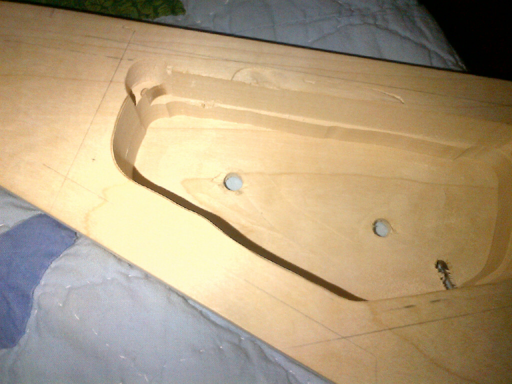

Toadroller Posted January 27, 2012 Posted January 27, 2012 Someone took a unique approach to lighten the body of my Daytona... I call that a "beehive route." Fugly and still fairly heavy but the excavation is covered by the pickguard. Since I found it it naturally reliced (plus this abuse) in September for two fitty, it's been my favorite Hamer. No worries about dinging her up. She plays and sounds great.

KH Guitar Freak Posted January 28, 2012 Posted January 28, 2012 Someone took a unique approach to lighten the body of my Daytona... I call that a "beehive route." Fugly and still fairly heavy but the excavation is covered by the pickguard. Since I found it it naturally reliced (plus this abuse) in September for two fitty, it's been my favorite Hamer. No worries about dinging her up. She plays and sounds great. I just died inside...

Toadroller Posted January 30, 2012 Posted January 30, 2012 I just died inside...It's not so bad. How else are you going to get a Daytona for $250? Aside from that abuse, this thing is stock and has obviously been played and played and played- the sweat stains in the cowboy chords area could tell a few stories. I can't put it down.I kinda did, but all I had to do was swap necks on 2 Daytonas I already had, to get what I wanted.Even so, 1 neck fit in easily, while the other took quite a bit of work (wood swelling?), although I've even had trouble getting a Daytona neck back on the same body it came off of, after some wiring work, which I'm guessing had to be due to swelling. Just remember to work on the neck pocket, not the neck.The neck on my green Strat is really tight. If it's summer, I lay the butt end of the neck over the A/C vent and take the body outside (and if it's winter, I take the neck out in the garage [never out into the real cold] and leave the body in the house). Just a few minutes of difference seems to shrink the neck enough to allow me to fit it into the pocket without chipping the paint (well, so far).When I was a kid, my father worked on all sorts of British motorcycles. BSAs, Nortons, Ariels were in our garage. He used to heat up the cylinder of an engine in the oven to be able to slide the pistons back in. Same concept.
cmatthes Posted January 30, 2012 Posted January 30, 2012 That would be a pretty easy thing to clean up with a router. Get that beehive stuff nice and tight, slap some shielding paint in there and it would look real purty.
Toadroller Posted January 30, 2012 Posted January 30, 2012 I'm not very good with a router, yet. Man, I have got to finish this project for my boy Henry.
