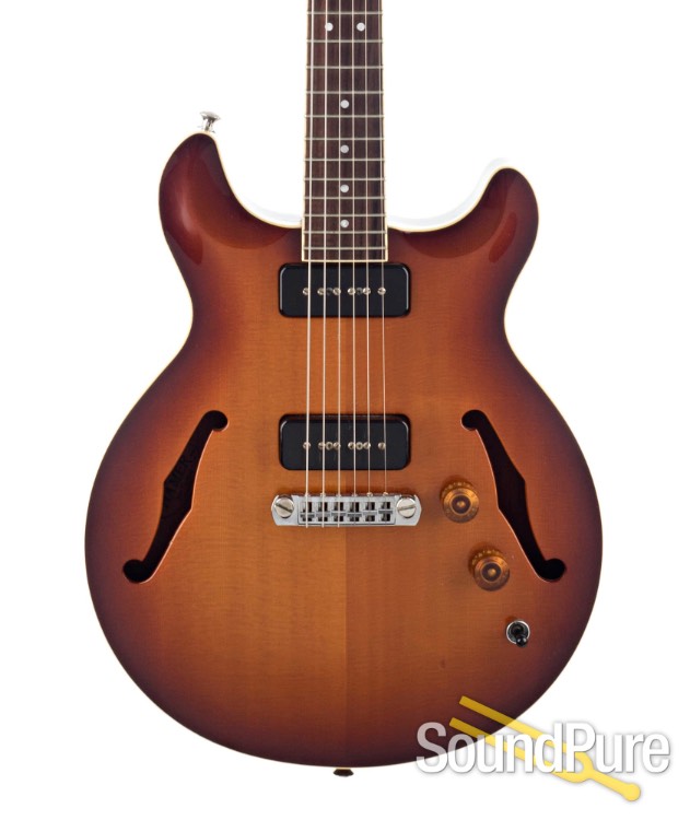

I already know from the seller of the incoming Newport that the intonation is a bit off in the higher frets.

With that said, are there any non-hideous compensated replacements that you would recommend?  Some brief Googling finds a lot of love for the MojoAxe bridges, and several butt-ugly options that would never be allowed into the house.
The look must remain the look.
Are Hamer and Gibson interchangeable in terms of the compensation/setting?  Do these things actually help?

Both @burningyenand @veatchuse the MojoAxe CWT-UA on Newport 90s, so I think the experts have spoken.  I'll decide later if I even want/need it.

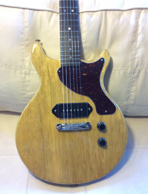

I pulled the Wilky wrap on my Korina Special Junior and replaced it with a Faber compensated that @cmatthesrecommended. It worked great…,and I DID visit the higher frets with no issue with that bridge.

I have the Faber compensated wrap tail on 3 guitars, and it made them all better.  I highly recommend that one - super lightweight too.
I've got the Schroeder on a guitar and am completely happy with it, also think its the sexiest option out there.
