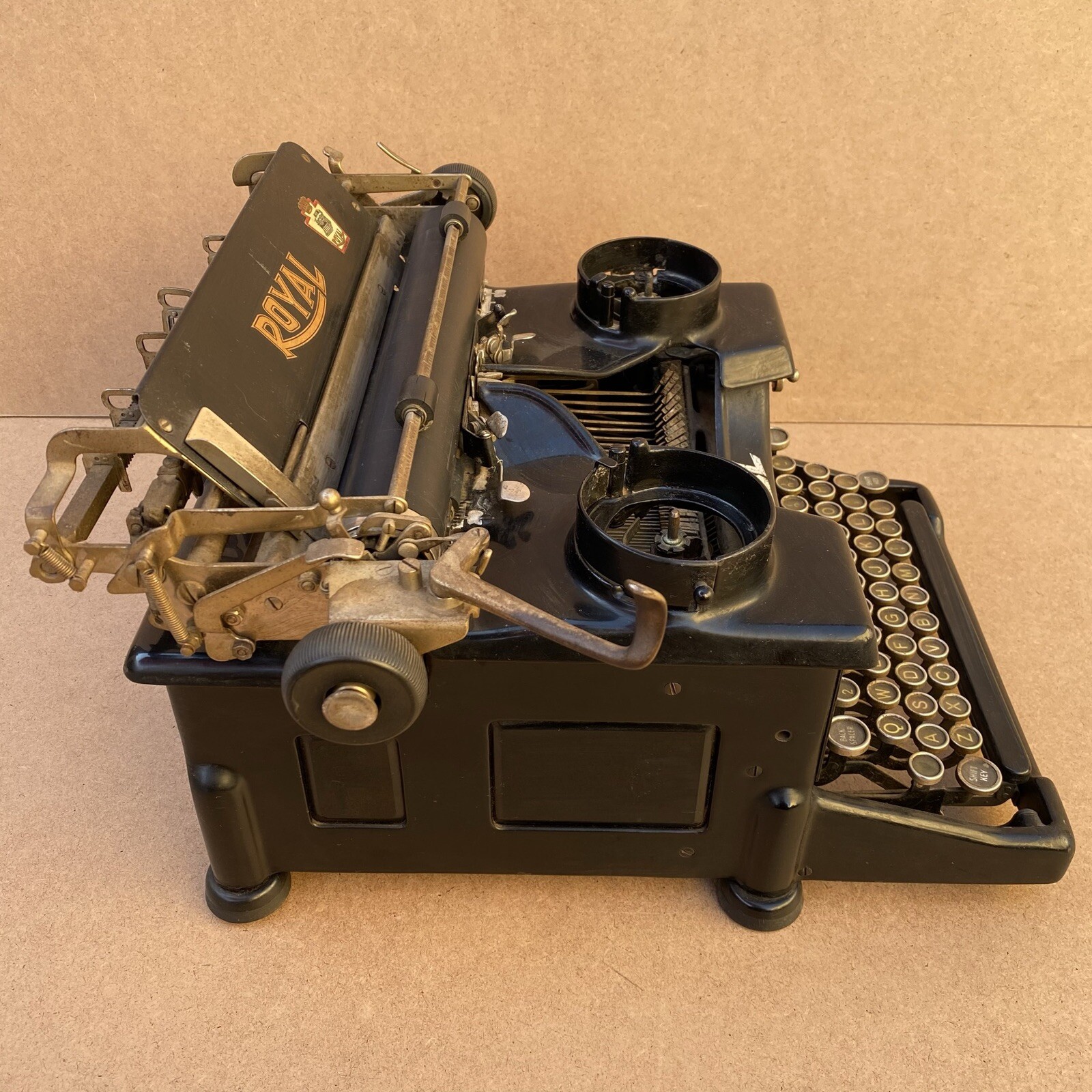

43 minutes ago, kizanski said:
shopping?q=tbn:ANd9GcRIR5iF2GVEt7v3oMZ-K
Kiss my whole ass.
5 hours ago, Cboss said:
WTF.. is that a chunk of Russian military hardware from the cold war?🤣
Close.  But closer to a piece of transcription hardware from the 1920s USA.
