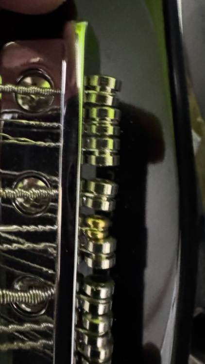

mathman Posted November 14, 2025 Posted November 14, 2025 So I bought a used bass that VincentYGB posted about in another thread. I didn't want to continue my journey in his thread so I thought I would start my own. I picked it up today. It is in very good condition finish wise. Almost looks new. Very little swirling in the finish by eye. More shows up in the photos. The reason he returned it was that the bridge was tilting up, presumably from string pressure. It is definitely tilting up but with the strings completely loose their is not movement or give in the bridge. I can barely make it move. Pictures below. So, if someone has insight about that I would love to hear. It has the double truss rod. If I understand correctly it is a parallel rod system and I need to adjust mostly equally. It came from dry and hot Arizona to normally dry and hot Florida. But we just had major cool front. Still dry. I usually have to do small adjustments to my guitars as we move into "winter" in central florida. If you have any guidance on the dual truss rod I would love the advice. Finally, Damn, a lot of strings to tune. I raised the saddle before I tried to do anything with the truss rods. The strings were resting on the fret board when relaxed. I knew that would change while tuning but for this first time I thought to give myself some extra room. The D strings are giving me trouble. I am using the tuner in Amplitube which is a computer based amp system. It has a pretty good tune that adjust to the full range. I have a digital tuner that clamps to the neck but it seemed very confused so I went to the amplitude version. It is a pain. Any tips on tuning one of these? 3 Quote

velorush Posted November 14, 2025 Posted November 14, 2025 With no string tension, can the tailpiece mounting screws be tightened to bring the tailpiece down to the face of the guitar? The tailpiece doesn't appear to be beveled on the bottom so that this is the engineered position. With that, it appears it would be loose without string tension. 2 Quote

mathman Posted November 14, 2025 Author Posted November 14, 2025 34 minutes ago, velorush said: With no string tension, can the tailpiece mounting screws be tightened to bring the tailpiece down to the face of the guitar? The tailpiece doesn't appear to be beveled on the bottom so that this is the engineered position. With that, it appears it would be loose without string tension. So I loosened all the strings to be slack but not removed. I could not make it move. I will loosen even more and see what happens. I am trying to find pictures of other import basses to see if I can compare. Quote
velorush Posted November 14, 2025 Posted November 14, 2025 1 hour ago, mathman said: So I loosened all the strings to be slack but not removed. I could not make it move. I will loosen even more and see what happens. I am trying to find pictures of other import basses to see if I can compare. Just spit balling, but I'd be inclined to (with string tension off) loosen the tailpiece mounting screws - not seeing it in person, I'm betting the bridge being in that position has artificially beveled the face of the guitar by digging into the wood. [Theory being: the tailpiece was installed originally with loosened screws and pitched forward under string tension, digging into the wood. It's been that way for so long it has attached itself in that position]. If you can loosen it up, then put it flat on the face, then retighten the screws, you should have the correct orientation when string tension is reestablished. [/spit ball] 3 Quote
cmatthes Posted November 14, 2025 Posted November 14, 2025 The tailpiece should lay flat on the face. If you really had issues or weren't able to intonate properly, you could probably drill out the Basswood body and plug with wider maple dowels or something, but that would be a lot of effort if you can get by "as-is". 12vers are FUN! 3 Quote
svl Posted November 14, 2025 Posted November 14, 2025 Turn the tailpiece "backward", drill new screw holes and it will lay flat as a pancake. 1 Quote
Hbom Posted November 14, 2025 Posted November 14, 2025 56 minutes ago, svl said: Turn the tailpiece "backward", drill new screw holes and it will lay flat as a pancake. Picture shows the strings almost sitting on back of bridge already. Wouldn't reversing the bridge make for a really bad break angle? 2 Quote

Hbom Posted November 15, 2025 Posted November 15, 2025 22 minutes ago, mathman said: I could move it back but it may be too close to the edge of the bass. Still contemplating my options. Any answer to why it isn't setting down flat? Are the screws bad? Can you put a piece of hardwood dowel in and reset the bridge with tight screws? Quote

Victor (Fret Friend) Posted November 15, 2025 Posted November 15, 2025 So those tailpiece holes are stripped right??? Only one way I'd fix this: Drill>Fill(dowel/glue)>Re-drill 👍 Quote
mathman Posted November 15, 2025 Author Posted November 15, 2025 4 hours ago, Victor (Fret Friend) said: So those tailpiece holes are stripped right??? Only one way I'd fix this: Drill>Fill(dowel/glue)>Re-drill 👍 Actually I don't think they are stripped. I think what Velorush said is a possible reason. I am still playing it for now. Working perfectly so far. 2 Quote
seeker Posted November 15, 2025 Posted November 15, 2025 Loosen tension on strings till it lays flat. Super Glue. You're Welcome. 2 Quote

topekatj Posted November 20, 2025 Posted November 20, 2025 @mathman if the anchor screws are tight on the L bracket (that the strings are attached to) then the L bracket is just bent. Have a machine shop fabricate something more HD and go with that. Quote
