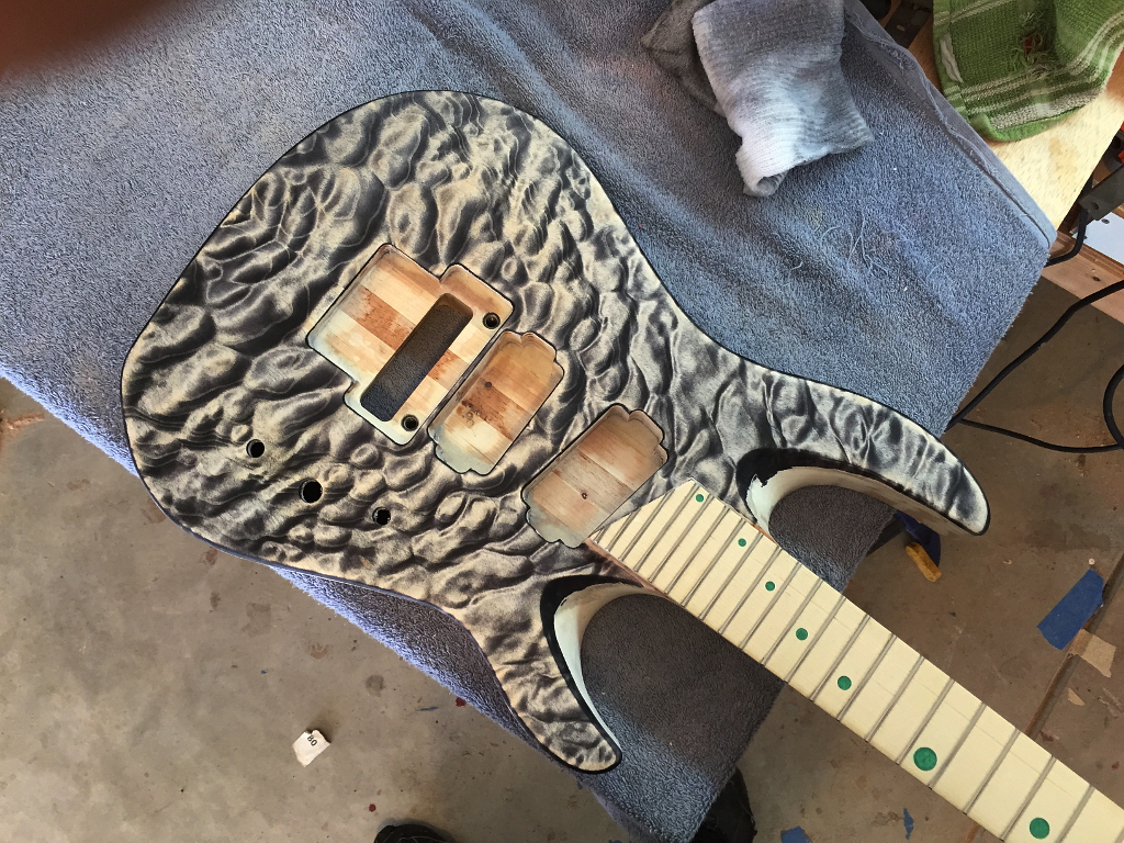

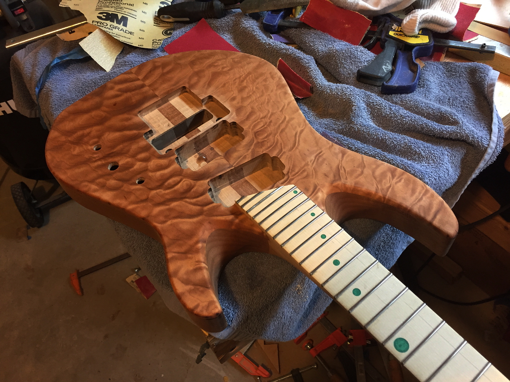

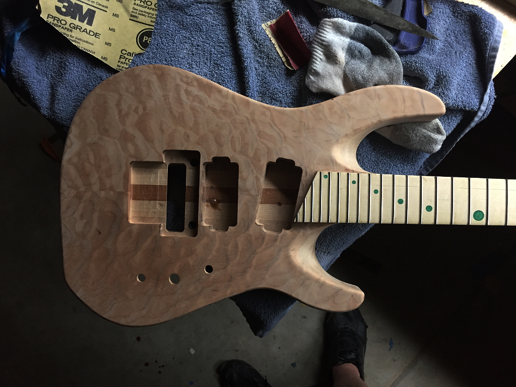

unfun75 Posted August 16, 2015 Posted August 16, 2015 Looks like caramel. I like caramel.That's the natural amber of that piece of maple accentuated by the naphtha I use to pop the grain for the pix.That's not what color it will be when I finish it. I'm going to bleach the Amber out of the top, pop the grain by dying it black and then sanding it off, and then shoot tinted clear nitro.I won't spill what color it will be. i won't ruin it for Jim :-)With the green inlay dots, I'm guessing it will have a green theme.
BTMN Posted August 16, 2015 Posted August 16, 2015 Green over that Quilt? Oh My, that would be spectacular! That is looking beyond.
Steve Haynie Posted August 16, 2015 Posted August 16, 2015 You could just clear coat over the wood and let the flame stand out on its own. It was explained to us at the Hamer factory that doing the finish that way allows the flame to look like it moves around more.
diablo175 Posted August 16, 2015 Author Posted August 16, 2015 Nah. Day-glo clown vomit burst with trans magenta tiger stripes overlaid. We'll never see a smidgen of the grain.
Meatbomb Posted August 16, 2015 Posted August 16, 2015 You could just clear coat over the wood and let the flame stand out on its own. It was explained to us at the Hamer factory that doing the finish that way allows the flame to look like it moves around more.It's a trade off. Depends on what effect you are going for.Dying it black and then sanding down does reduce the chatoyancy. It doesn't eliminate it though, just subdues it. The Payoff Is that the grain and contrast is brilliant and in your face.I do them both ways and like both effects.Jim wants "in your face"
diablo175 Posted August 16, 2015 Author Posted August 16, 2015 Jim wants "in your face"Is there any other way? I suppose "melt their f-ing faces off" would be acceptable, too.Go big or go home.
