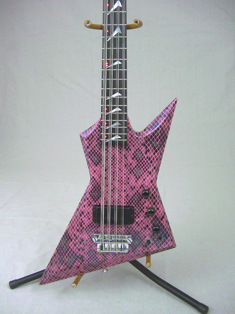

Although the bright dayglo Fushia is commonly the one referred to as "Pepto Pink," Hamer also did a custon pastel pink that was more like a Pepto Pink.....like the color of Tom Petersson's original 10-string Bass or Pete Farndon's B4S he used in The Pretenders or Shakira's Special.
Then....Hamer also did a Pink Pearl Snakeskin by Jim O'Connor like this:
