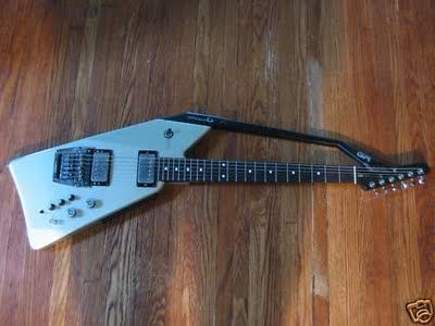

I had an Electra Outlaw that did this to a minor extent. I always figured it was because the neck pickup was right against the end of the neck and they'd scooped sooo much material out to make the joint fast.
