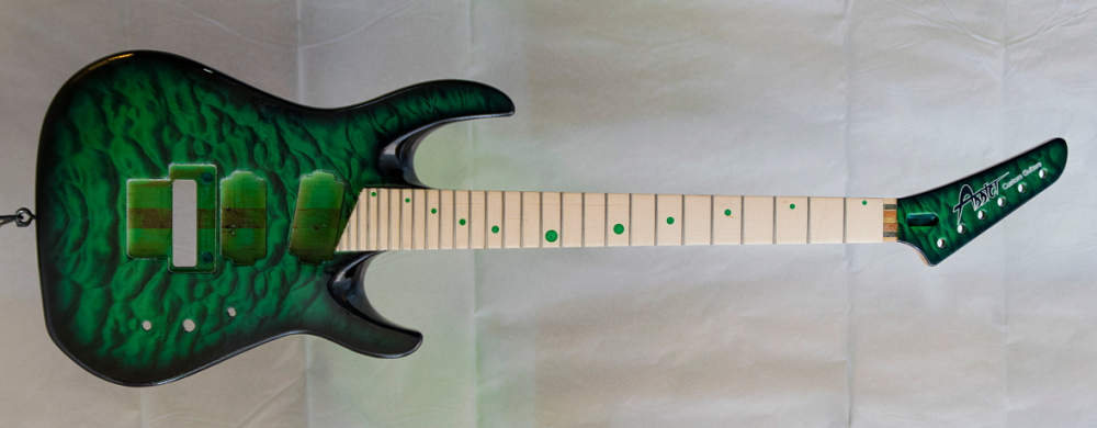

diablo175 Posted July 24, 2019 Author Posted July 24, 2019 18 minutes ago, Dutchman said: What type of top is that? Maple? Is that the finish? It looks like the surface of the moon!! Very very cool!!! Quilted maple and no, the finish was this: Quote
killerteddybear Posted July 24, 2019 Posted July 24, 2019 1 hour ago, diablo175 said: Quilted maple and no, the finish was this: Clear coat, clear coat, clear coat... 1 Quote
diablo175 Posted July 24, 2019 Author Posted July 24, 2019 8 minutes ago, killerteddybear said: Clear coat, clear coat, clear coat... Not likely- the quilt top is a 1/4 inch slab of maple and the seam has to be sprayed opaque just like in the original finish. However, since this is getting additional work done to the trem recess cavity and that will need to be hidden as well, I'm leaning towards a complete opaque finish. But I agree- it's a purdy top. 1 Quote
Dutchman Posted July 24, 2019 Posted July 24, 2019 1 hour ago, killerteddybear said: Clear coat, clear coat, clear coat... I agree!!! It looks tit’s the way it is!!! In the pic anyhow... Unique!! 1 Quote

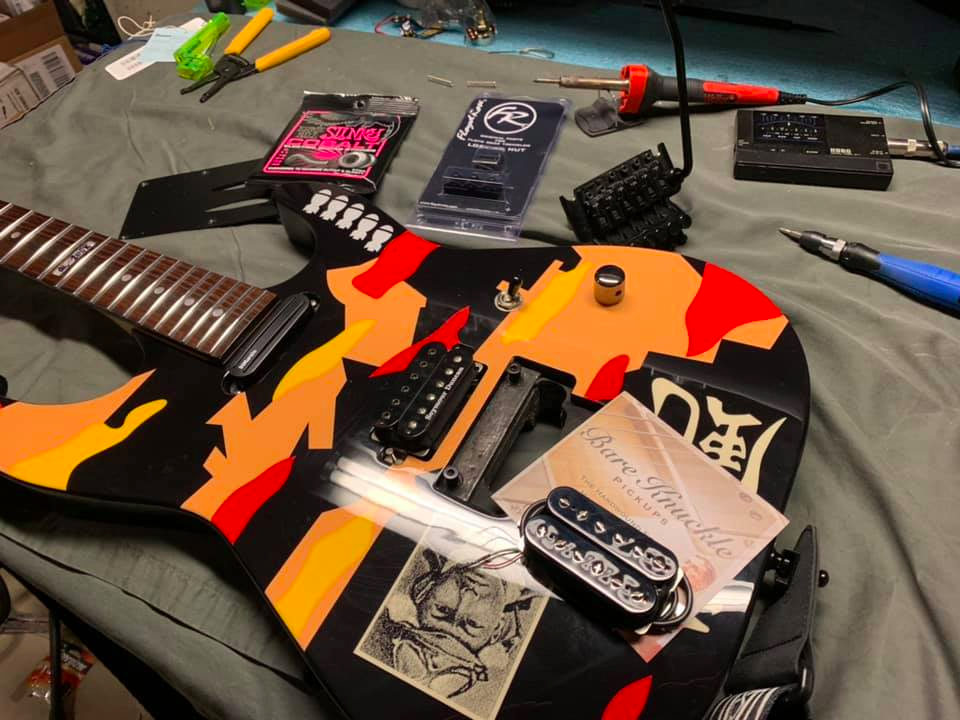

diablo175 Posted September 2, 2019 Author Posted September 2, 2019 Haven't posted here in a while (since July) so this is timely- took the recently acquired LTD Lynch Kamikaze and gave it a much-needed overhaul. The previous owner actually started it down the path of resale ruination by adding a rout for a toggle switch and putting slightly better p'ups in- a Custom 5 and a Dimarzio Chopper. Meh. The SH-15 came out for a Bare Knuckle Warpig on a glowing endorsement from @DBraz. He was fully on point- the Warpig is a hot rod, flame-throwing rocker with tons of output- (21K) but tames nicely with volume knob tweaks. It has great high end bite without being shrill and has a nice, tight low end- just right for my use. Naturally, the POS stock FR Special trem had to go and post haste! That was replaced with a like-new Schaller Lock Meister w/ 37mm brass fat block I happened to have lying around on the bench. Hily shit! What an improvement! The guitar plays and sounds significantly better and with the intended addition of a kill switch vol pot, it'll be a nice little stunt guitar. 3 Quote

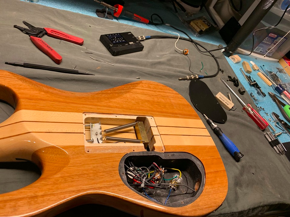

diablo175 Posted September 20, 2019 Author Posted September 20, 2019 Naturally, I modded my recent BC Rich acquisition with the addition of a kill switch tone pot and a new-ish LockMeister and big brass block. It stands to reason that after you've done certain tasks over and over, you're likely to get pretty good at it and I thought this was such a case. Oh ho! Not so fast! Ran into a bit of a soldering & wiring issue that, suffice it to say, stymied any sound from happening. I was a bit frustrated, especially since this was something done before. The real hang up was in the fact that what was amiss, wasn't obvious and I had little in the way of diagrams or schematics to follow. My reflex response was to phone up a local tech (though Shane Huss has been pretty damn good about helping walk me through other minor issues) and punt it off to him. Thus, I had a few hours before I was to drop it off with the tech when I decided to take one more look at it. I checked and re-checked and reviewed the only diagrams I did have, of which neither fully addressed the necessary routing of wires. I had to extrapolate and combine info from both to achieve a complete picture. Long story short, my effort paid off! It was several items- a bad wire the previous gent had used and my mis-routing a few lines as well. But persistence won the day and I'm a tiny bit more knowledgeable and better off for it! It ain't pretty but it works!!! 1 Quote
