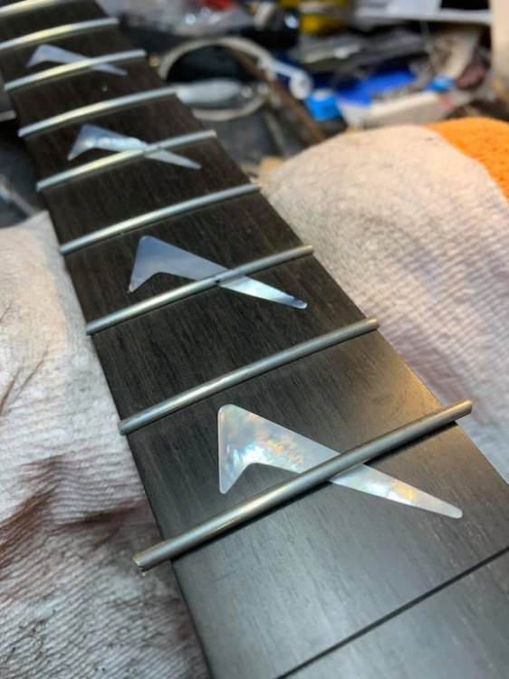

Travis Posted January 15, 2021 Posted January 15, 2021 30 minutes ago, diablo175 said: The more I look at this picture, the more I get this crazy idea for a Phantom Jr... 🤔🤔🤔
diablo175 Posted January 15, 2021 Author Posted January 15, 2021 21 minutes ago, Steve Haynie said: Those inlays are a little over the top, are they not? Good! I need any and every option/tactic to distract from my awful playing.
diablo175 Posted January 15, 2021 Author Posted January 15, 2021 To paraphrase SirMixaLot- I like BIG frets and I can't deny...
Travis Posted January 15, 2021 Posted January 15, 2021 23 minutes ago, diablo175 said: To paraphrase SirMixaLot- I like BIG frets and I can't deny...
Dave Scepter Posted January 15, 2021 Posted January 15, 2021 2 hours ago, diablo175 said: To paraphrase SirMixaLot- I like BIG frets and I can't deny... Hey Jim, have you tried a light scalloped neck?
diablo175 Posted January 15, 2021 Author Posted January 15, 2021 22 minutes ago, Dave Scepter said: Hey Jim, have you tried a light scalloped neck? Yup. Didn't appeal to me. But that may be old(er) age and my aversion to change in play-
diablo175 Posted January 15, 2021 Author Posted January 15, 2021 4 hours ago, Dave Scepter said: Hey Jim, have you tried a light scalloped neck? I think the other issue is that you can always move to smaller frets if I'm not mistaken (assuming fret tang is the same size) but once you scallop, that's it. No going back to non-scalloped.
Dave Scepter Posted January 16, 2021 Posted January 16, 2021 2 hours ago, diablo175 said: I think the other issue is that you can always move to smaller frets if I'm not mistaken (assuming fret tang is the same size) but once you scallop, that's it. No going back to non-scalloped. "IF" you only had one guitar... and we both know you have many to choose from 😉 I look at it as having one guitar with a shorter scale and another with a longer scale, one with active pickups etc.
Travis Posted January 29, 2021 Posted January 29, 2021 50 minutes ago, diablo175 said: Oh, god... that’s coming along nicely... 🤤🤤🤤
scottcald Posted January 30, 2021 Posted January 30, 2021 On 1/15/2021 at 10:15 AM, Steve Haynie said: Those inlays are a little over the top, are they not? Good! I thought for @diablo175 they looked restrained to on par. What are you calling this one, the Phantofornian?
diablo175 Posted January 30, 2021 Author Posted January 30, 2021 1 hour ago, scottcald said: I thought for @diablo175 they looked restrained to on par. What are you calling this one, the Phantofornian? Califantom Actually, I'm calling it a Specter
BubbaVO Posted January 31, 2021 Posted January 31, 2021 On 1/15/2021 at 10:32 AM, Travis said: The more I look at this picture, the more I get this crazy idea for a Phantom Jr... 🤔🤔🤔 Hell yeah!!!

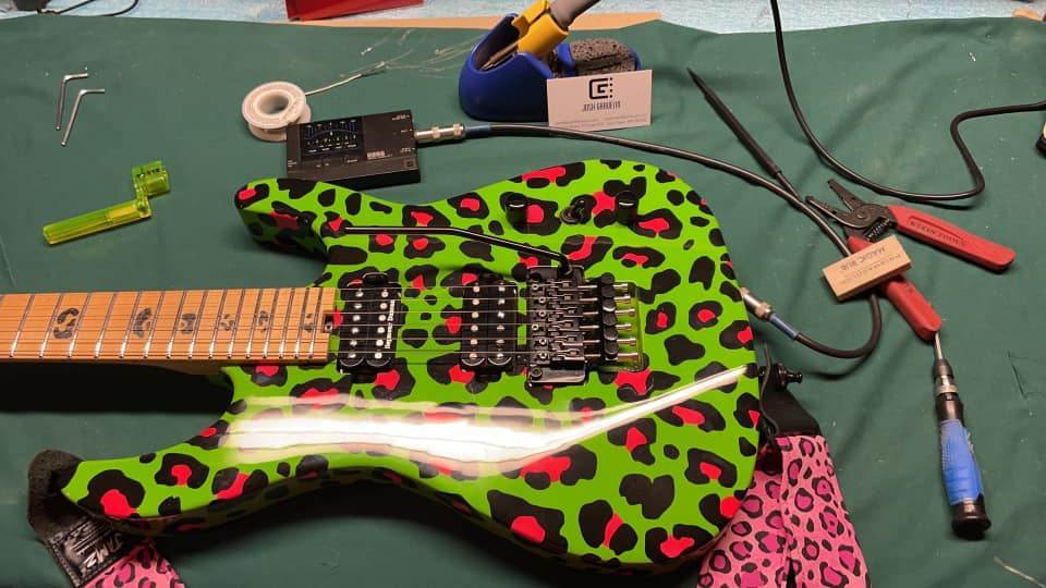

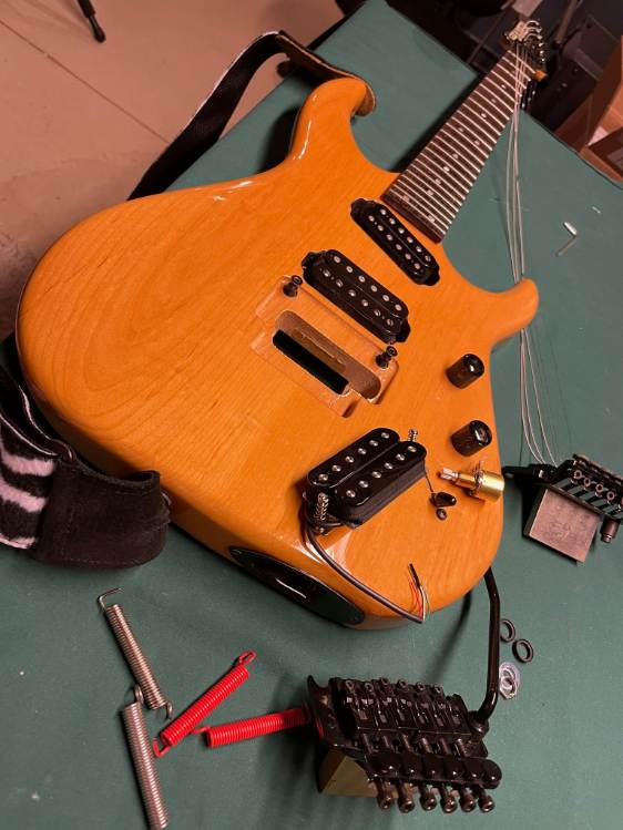

diablo175 Posted May 13, 2021 Author Posted May 13, 2021 Latest Hamer acquisition is getting an upgrade -Schaller Lockmeister Floyd with 38mm short string screws and fat brass block, new studs and posts, Gravelin Pickups Double Slug Mongoose in the bridge, a Fixit EZ 500K kill switch/tone pot, noiseless, coated HD springs. Depending on a few factors, it may get a new set of jumbo stainless Jescars. At the very least, it'll get the neck back scuffed up with 0000 steel wool or 1200 grit sand paper for a more satin-y feel. Mmm.
slingblader Posted May 13, 2021 Posted May 13, 2021 Cool project. Out of curiosity, where did you source the Lockmeister? I've looked for these in the past but couldn't seem to get my hands on one.
diablo175 Posted May 13, 2021 Author Posted May 13, 2021 7 hours ago, slingblader said: Cool project. Out of curiosity, where did you source the Lockmeister? I've looked for these in the past but couldn't seem to get my hands on one. Can't recall precisely, honestly. Online from somewhere. Likely Reverb. I do know that in the last year , Floyds and Lockmeisters have been exceedingly hard to find because of the pandemic- production in Germany and distribution stateside were impacted and there was an increase in guitars and components being bought due to folks being locked down?

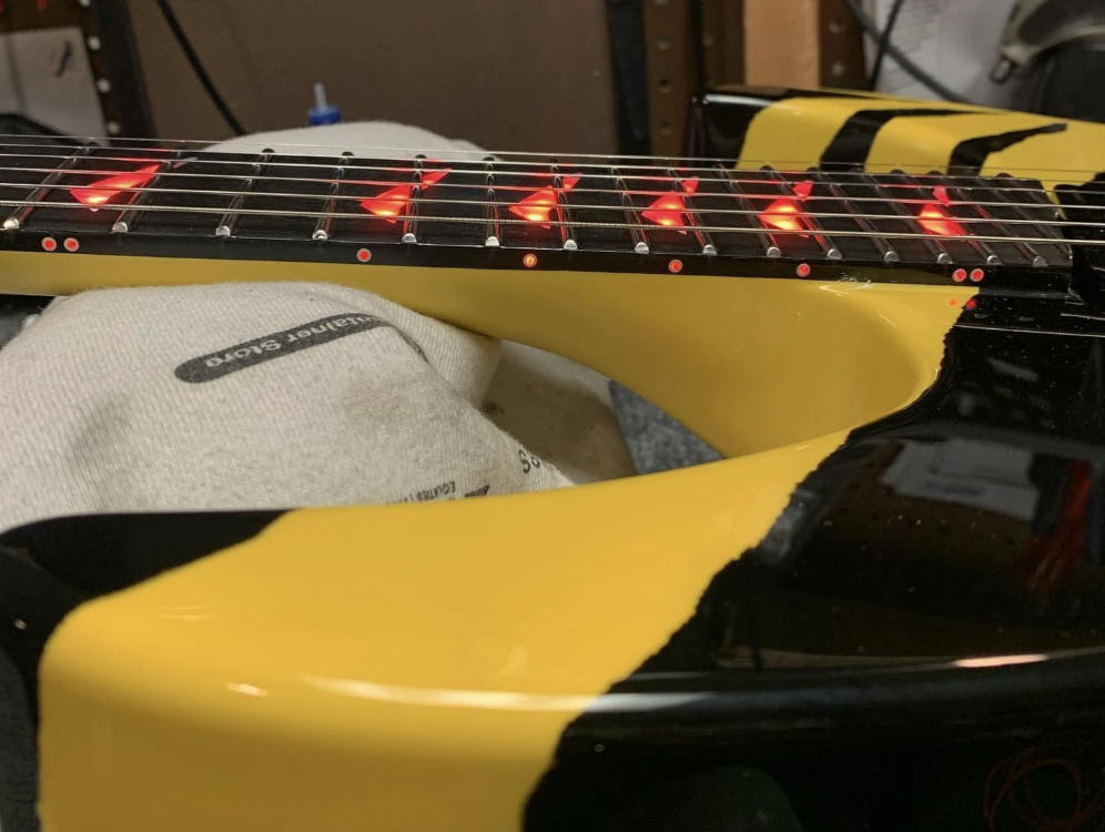

Biz Prof Posted May 26, 2021 Posted May 26, 2021 6 minutes ago, diablo175 said: Something wicked this way comes... C'mon man....
diablo175 Posted May 26, 2021 Author Posted May 26, 2021 9 minutes ago, Biz Prof said: C'mon man.... C'mon what? I don't have a shot of the whole guitar with lights and strings and everything. It'll be here by Friday or Saturday. You can wait until then. Just like me.
Biz Prof Posted May 26, 2021 Posted May 26, 2021 9 minutes ago, diablo175 said: C'mon what? I don't have a shot of the whole guitar with lights and strings and everything. It'll be here by Friday or Saturday. You can wait until then. Just like me. Well, damn....OK.

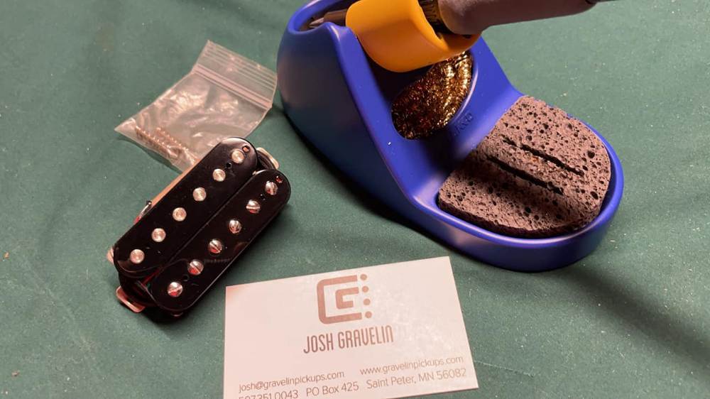

diablo175 Posted August 3, 2021 Author Posted August 3, 2021 While awaiting completion and delivery of my HEL Spitfire 2, I've decided to introduce yet one more variation from the original Spitfire (aside from headstock style and body wood). Duly impressed with how a stock TB-4 in my Charvel sounds, I decided on a Gravelin pick up different from the double slug Mongoose in SF1. I wanted something with a little more of the JB honk and snarl, while retaining some of the fuller tonal characteristics that the Mongoose offers over a JB. As per usual, Josh delivered in epic fashion! In our discussions about specs, we determined that the alder body of the Spitfire 1 might also benefit more from the Mongoose T we were spec-ing up. So, I threw it in Spitfire 1. Glad I did! Game changer as it is an effective workaround to the alder body’s tendency to tame certain frequencies and emphasize mids. And just to confuse things a bit more, the double slug variant I pulled out of Spitfire 1 will go into the Spitfire 2. The thinking being that the DS Mongoose will work better with the 'hog body of SF 2 as is the case with my recent HEL Specter. The DS in that ax is absolutely crushing but retains a little more treble.
RobB Posted August 3, 2021 Posted August 3, 2021 Is that ^^^^ the Spitfire 1? I'm confused; must be all the bright colors. Is the 2 similar to the first one?
diablo175 Posted August 3, 2021 Author Posted August 3, 2021 8 hours ago, RobB said: Is that ^^^^ the Spitfire 1? I'm confused; must be all the bright colors. Is the 2 similar to the first one? No, you’re just getting old Yes, that is Spitfire 1 shown above. Yes, Spitfire 2 is similar; the same style of guitar (dinky) with several variations.

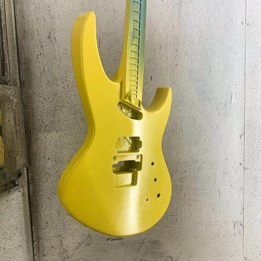

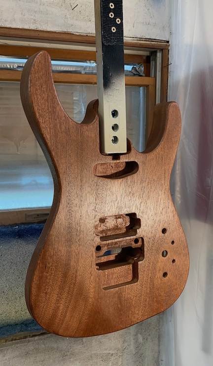

diablo175 Posted August 3, 2021 Author Posted August 3, 2021 Technically not on/from my bench but definitely a build for based on specs from me. Spitfire 2 is days away from paint!!!
