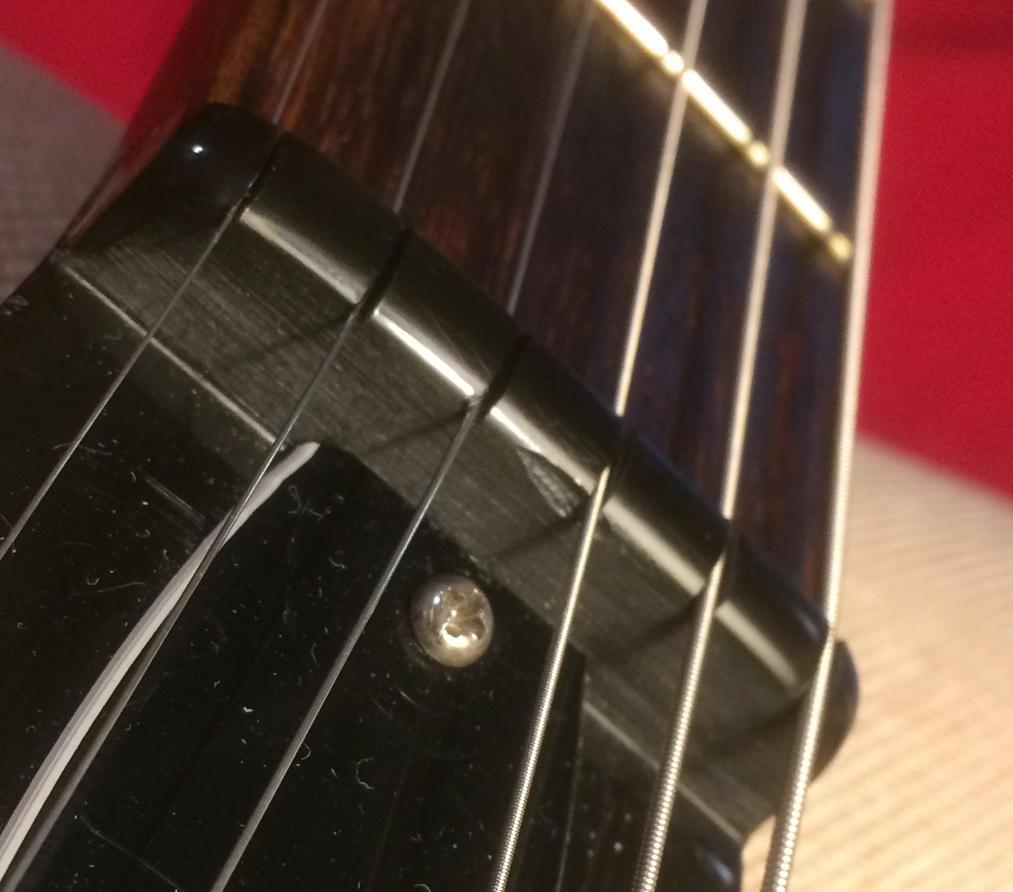

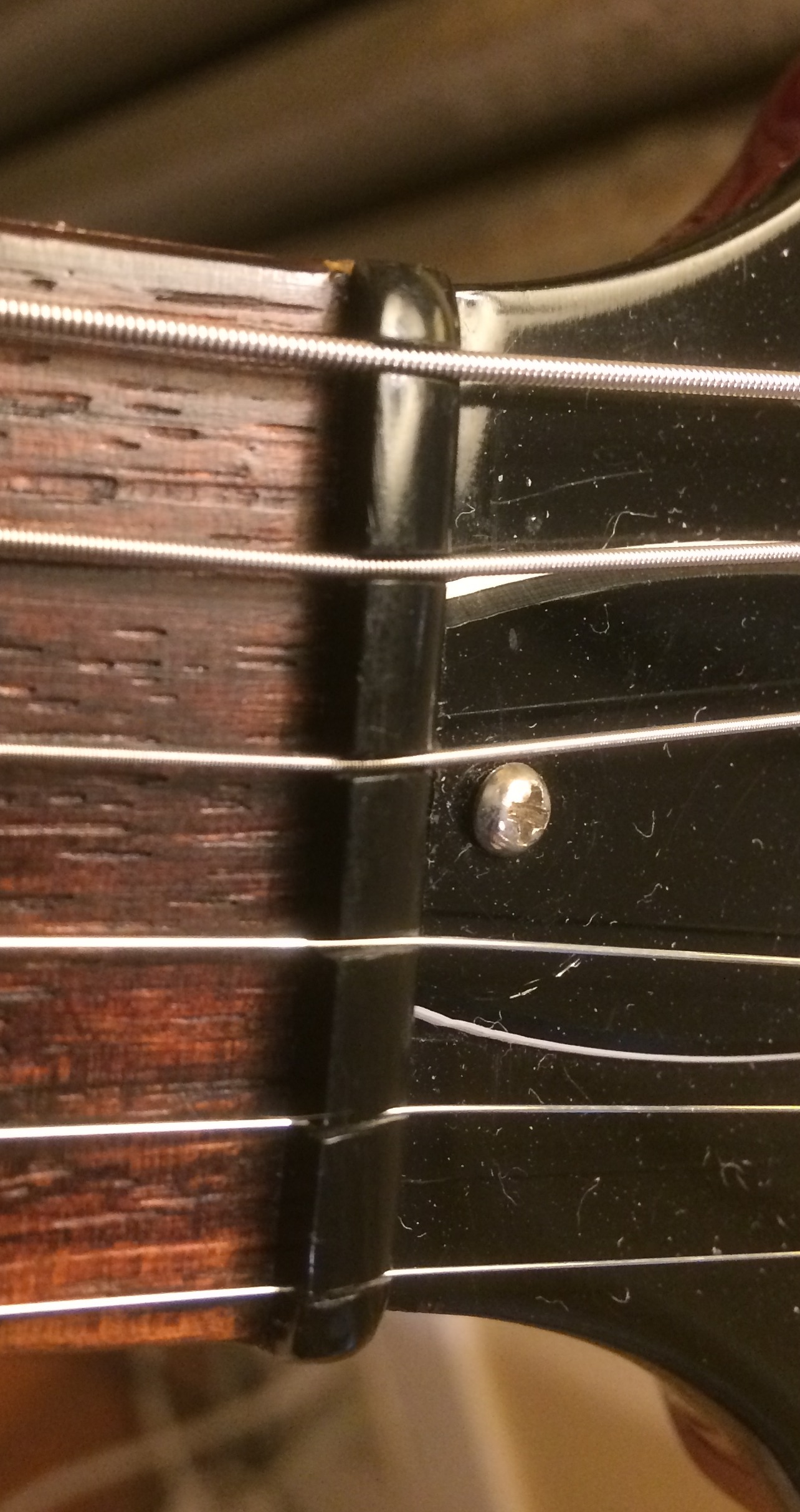

marmatkat Posted October 8, 2017 Author Posted October 8, 2017 Thanks so much for the helpful comments, everyone. Much appreciated. Re: lubitrak vs. plain plastic, how would I tell looking at it (please see attached pics)? Re: pickups, I bought the guitar used for $550, and it came with Lollar '50s Wind P-90s, which I like, though I've not compared them to whatever was stock.
polara Posted October 8, 2017 Posted October 8, 2017 If it’s black and came on it originally, it’s a perfectly good nut. The way it’s cut - and of course if it’s just worn out if, say someone used mad-heavy strings - matters more than material. That’s the factory nut. Keeps the strings on and stays in tune? I’d keep it You got a very good deal! Tastes vary but Lolars are very highly regarded here. I happent to like the stock Duncan’s but they’re a bit louder and less... let’s say, full-range than the Lollar P90s I’ve tried. Different flavors. You’re gonna like that guitar, I think!

BTMN Posted October 8, 2017 Posted October 8, 2017 Welcome! First Hamer too? Hide your wallet. That looks lkie a Lubritrak to me. Interesting chip there wonder how that one happened.
