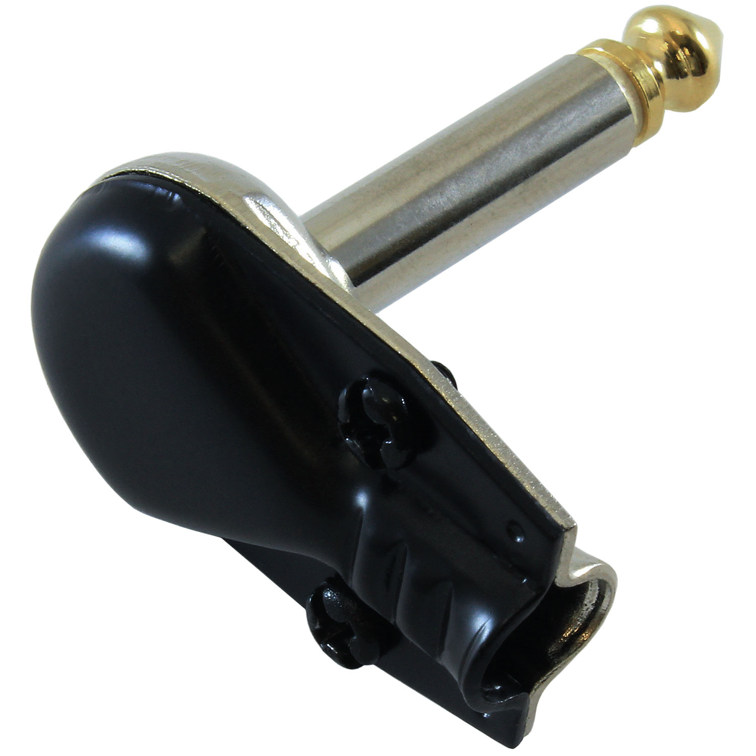

    If you're handy with a soldering iron, or have a friend that is, make your own with pancake jacks, custom length cords really tidy up your board, plus the pancake  jacks free up some valuable space; I made mine three years ago, and numerous shows later absolutely no problems.
 I went for a mid-priced jack , about two dollars a piece , Switchcraft ones  are around eight dollars if that will give you extra peace of mind.

Yeah, been thinking of this. Would be so much better than solderless.  Probably does not take more time to solder them either, than to mess with the solderless contacts, they are tidious the get right. Thanks for the input.
I love those flat plugs but you have to be sure not to put a big glob of solder in there - there's not enough room!
