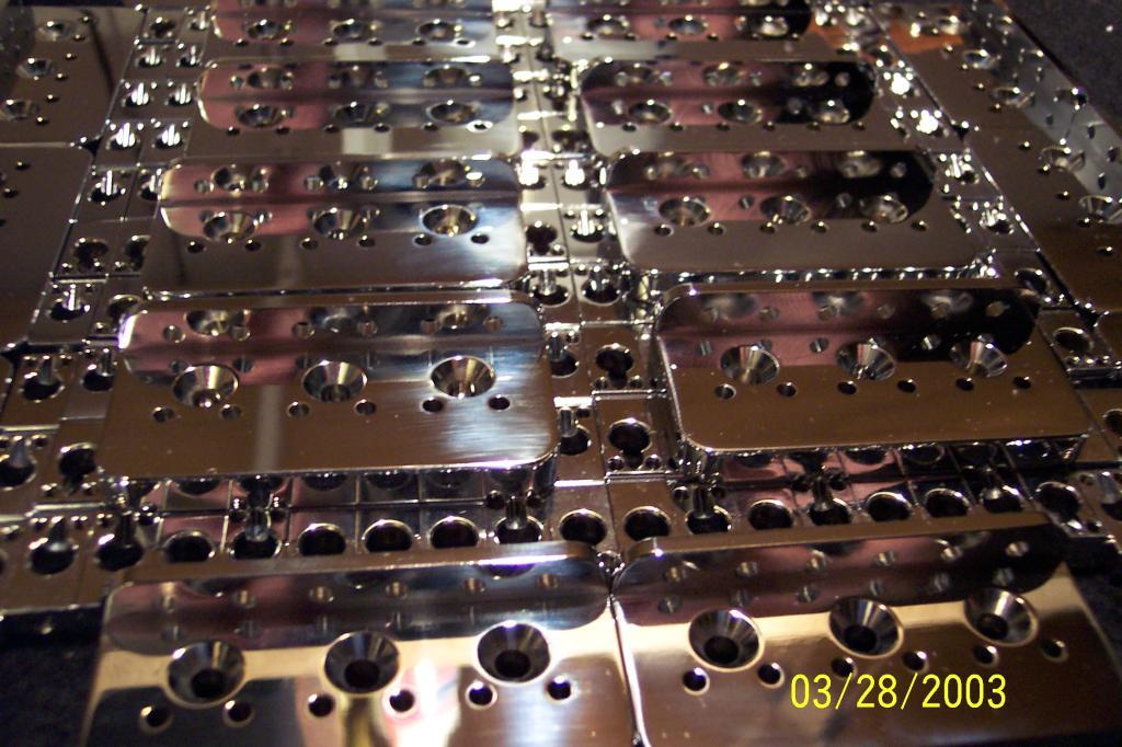

hamerhead 15,994 Posted January 22, 2019 Share Posted January 22, 2019 I had to mess with it.... just for fun: 7 2 Quote Link to post Share on other sites
hamerhead 15,994 Posted January 22, 2019 Share Posted January 22, 2019 8 1 Quote Link to post Share on other sites

bruce919 813 Posted January 22, 2019 Share Posted January 22, 2019 11 hours ago, hamerhead said: I had to mess with it.... just for fun: I like how you nested in the saddles to machine them all at one time. Nice. Quote Link to post Share on other sites
hamerhead 15,994 Posted January 22, 2019 Share Posted January 22, 2019 Thanks. The thought of loading hundreds of them little f***ers one at a time really sucked. I got 14 to a bar (7 on a side, then flipped, in a 4" vise), and was able to drill and tap the end holes 7 at a time in the next op. It burns up more material but the time and headache saved was worth it. 6 Quote Link to post Share on other sites
Never2Late 570 Posted January 22, 2019 Share Posted January 22, 2019 17 hours ago, DaveX said: On 20th Sept. 2018 you(Never2Late) posted this: "I tried, and failed, to have John Mann at MannMade make Sustainblock replicas......he has the machine-shop, the tooling, the expertise (original bridge designer/manufacturer to PRS who made bridges for them for 30 years), and the specs. I sent him an original USA Hamer TLE for a few months to dis-assemble and take all the measurements and make a prototype......then I got excuses/delays/run-around. For months. I gave-up working with him - he wants to sell his designs/products, when he's darned-good-and-ready to make them. I told him there was a LINE of people who would pay for them if he made them...to no avail....back to square one. I still need a Sustainblock for a Blitz project Stike is finishing-up, if anyone has a line...." Has something changed since then? I have also sent various emails to John Mann- never heard a thing back from him!! I dunno......John "talked" a good game to me. Unless someone has a recent photo of this "prototype" he built, I'm reserving judgment for now. I made several visits to his shop personally, since I'm only one hour away by car. I saw HIS bridges in the shop - I did not see a Sustain Block prototype, nor was I promised that he would make them or that he had made anything at-all. Quote Link to post Share on other sites
stonge 1,158 Posted January 22, 2019 Share Posted January 22, 2019 2 hours ago, hamerhead said: Thanks. The thought of loading hundreds of them little f***ers one at a time really sucked. I got 14 to a bar (7 on a side, then flipped, in a 4" vise), and was able to drill and tap the end holes 7 at a time in the next op. It burns up more material but the time and headache saved was worth it. I had a drill jig with bushings to drill one base at a time, and a different drill jig to drill 6 saddles as a strip but then you had to cut them off the strip. Had a separate fixture for milling the string ramp (blew up a ton of really small ball-radius end mills). Now for the kicker: I tapped every f'ng thread by hand (didn't have a machine to do that). That's three per saddle, or eighteen per complete bridge, all by hand. Still have saddles in a box in the basement with broken taps sticking out of them. At least that work could be done inside the house, and not in a 50-degree garage in the winter like all the other steps. Glad I only made two dozen bridges. That was more than enough. 1 1 2 Quote Link to post Share on other sites
