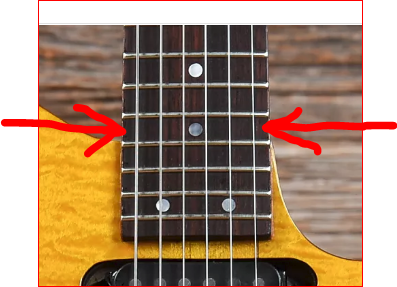

kizanski Posted January 21, 2019 Posted January 21, 2019 1 minute ago, Joe G said: ...I need a consensus of which width saddles/sustainblock bridge to send him. As wide as possible, otherwise you end up with this... ... no bueno.
