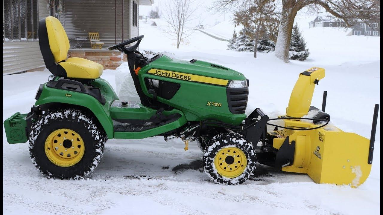

Not a blower but very popular in my area and they really move snow!!
1 hour ago, hamerhead said:
But is Johnny's little brother going to be anywhere near as effective?  Here's my lawn mower, L118 (42"?).  They do sell the snow blower attachment:
