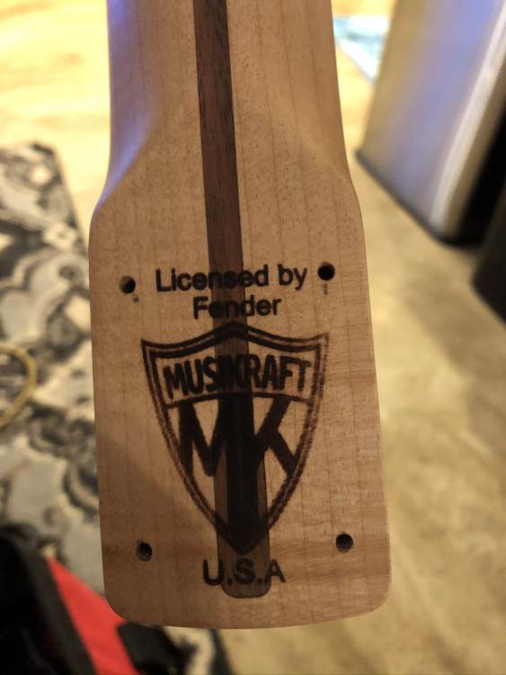

I’m putting together a parts Strat. The neck arrived today and I love the profile, but when I tried to bolt it onto the pre-drilled body, the bottom screws went in, but the top holes don’t quite line up.  See the indentations in the pic that show where screws hit.  What’s the best way to address this?
Musikraft is pretty much dead-on Fender spec, although sometimes their "seconds" on eBay are drilled for Tele on a Strat heel or vice versa, so may be slightly off.  Where is the body from?
Not sure of the manufacturer for the body. I bought it from a refinisher.  I hate that it’s so close.
Any suggestions for doweling such tiny holes?
Yeah - I should have said to dowel the neck. D'oh!
Suggestions? It depends on what you're using for doweling material, but I would drill the tiny hole out to a size just slightly smaller than the dowel you are using so it's a nice tight (but not too tight) fit. Put a very small amount of Elmer's on the dowel and gently tap it in with a BFH.
You could also just jam a bunch of toothpicks slathered in glue in there and call it a day. A little crude, though.
Drill holes to 5mm diameter and dowel. Redrill holes in the correct place. Nice easy job...
Ok, Lowe’s had 3/16 poplar and 1/4 oak.  I bought both.  I would prefer to use oak because it’s harder, but I like the smaller size of the poplar.  I’m experimenting on a 2x4 to see how it goes.
Either should work.  You could also order a set of those screw retainers.
New holes drilled and dowels installed today.  Will drill screw holes tomorrow.  So far, so good.  Thanks guys.
