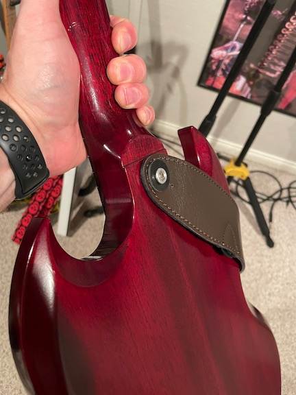

What kind of SG is it? Does it have the long or the short neck joint, and is it a beefy neck or a slim taper?
I really haven't had much trouble with my SGs over the years, as long as they had a beefy neck. I have only owned 5 though (2 currently).
It's the kind with strings on it. :P
Looks to be a 2013 SG Future Tribute although previous owner(s) added the pickguard, chrome p'up covers and new tuners to mine.
http://legacy.gibson.com/Products/Electric-Guitars/SG/Gibson-USA/SG-Future-Tribute.aspx
Like I mentioned before: 'Townshend-style neck/string bends'. :rolleyes:  And also why I don't have set-neck mahogany guitars that have lots of neck clear of the body anymore.
