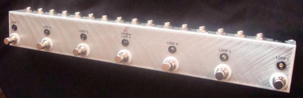

You know if Eric Johnson is on the list, it's beyond reproach LOL. Check out their specials page! https://www.loop-master.com/specials-c-47.html
I use the 7-Looper strip. They have it on sale for $99 right now. You can't beat that with a stick! This is what I have:
They have an 8-looper with Master Bypass and Tuner Out w/ Mute on sale for $129! 5-loopers for $69. Check out that specials page, you'll thank yourself for it!

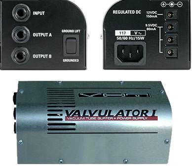

  Being a rackmounted & floor processor effects rack kind of guy, I recently switched over to using a VHT Valvulator tube buffer & Fractal Audio FX-8 floor processor mounted on a Pedaltrain Pro pedal board and am enjoying the sounds, versatility, and control over my effects & amp channel switching all in one box without multiple patch & AC cables, or tone suckage.
