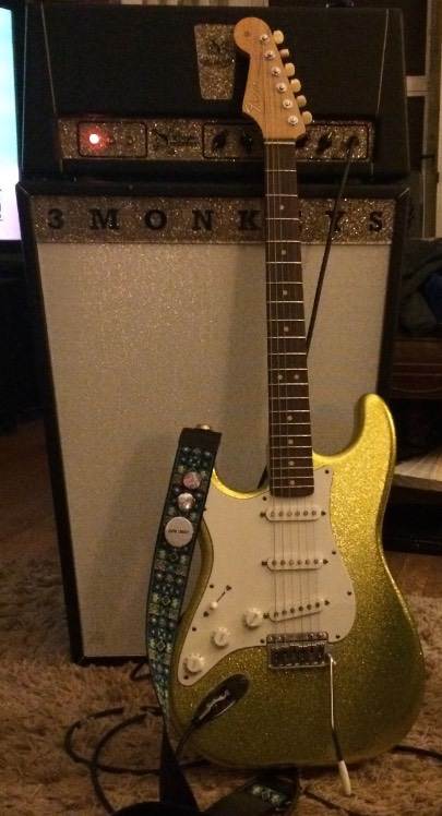

cmatthes Posted November 14, 2021 Posted November 14, 2021 Chartreuse Metalflake may be my favorite. Top 3, for sure!

slingblader Posted November 15, 2021 Author Posted November 15, 2021 4 hours ago, cmatthes said: Chartreuse Metalflake may be my favorite. Top 3, for sure! Oh man, Chris, she's a beaut!
