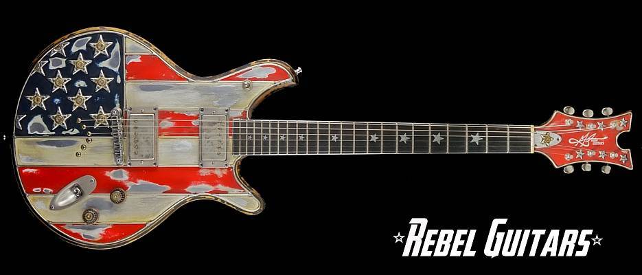

django49 Posted December 2, 2021 Posted December 2, 2021 Howzabout Buck Owens meets Evel Knievel with a touch of John Rambo? The stars are “riveted” with .357 magnum shell casings.
Drew816 Posted December 2, 2021 Posted December 2, 2021 2 hours ago, django49 said: Howzabout Buck Owens meets Evel Knievel with a touch of John Rambo? The stars are “riveted” with .357 magnum shell casings. .357 Magnum; come on! If you're going full guitar Americana they should be .454 Casul, .460 or .500 S&W Magnums man! 😉 The only revolver I still own is a .357, great caliber with a lot of flexibility. I just had to be a smart a$$!
slingblader Posted December 2, 2021 Author Posted December 2, 2021 7 hours ago, Steve Haynie said: Stike did an Even Knievel paint job. http://www.rowycokustoms.com/GalleryPages/RK_gallery004.html Stike is the freaking man. That had to be a pain in the ass to mask all those stars around the perimeter! I was looking at his gallery earlier today... I'm strongly considering just sending all my stuff to him from now on. These flake Teles have really burned me out. 2 hours ago, django49 said: Howzabout Buck Owens meets Evel Knievel with a touch of John Rambo? The stars are “riveted” with .357 magnum shell casings. Damn, now that's pretty cool too. Although that Strat jack plate looks like ass on the front of that guitar... just my opinion of course.
