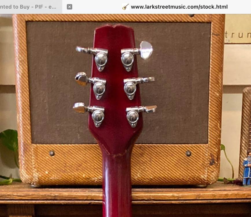

ARM OF HAMER Posted April 7, 2022 Posted April 7, 2022 Yeah....................... poor description of the break on the headstock on that early Hamer[And "MINTY CLEAN" NOPE!]................not a bad guitar otherwise providing there are no other surprise issues that are "SUFFICIENTLY" repaired. That guitar REALLY took a hit as it looks to have some heel damage also. And that "Crack" on the headstock you can clearly see it went into the face, OUCH! If I bought that guitar it would be going straight along to Jay @ NTL for a proper repair job, he would do it right.
Dutchman Posted April 7, 2022 Posted April 7, 2022 Expertly repaired is done with routed splines, stronger than before break. Sufficiently repaired is somebody glued it back together. Questionable repair is elmers and drywall screws. Not repaired is working tuners not included.

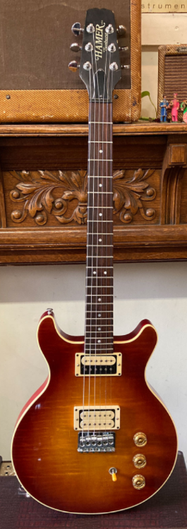

kurtsstuff Posted April 8, 2022 Posted April 8, 2022 Something with the bridge and the low E string that's basically off the fretboard??
kizanski Posted April 8, 2022 Posted April 8, 2022 9 minutes ago, kurtsstuff said: Something with the bridge and the low E string that's basically off the fretboard?? And given the angle at which the photo was taken, this isn't a case of the "photo lying." If anything, the angle is hiding how bad it really is. That wound E string is actually hanging off the fretboard. Never mind "sufficiently repaired." I'd wager that guitar isn't even playable.

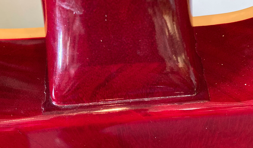

santellavision Posted April 9, 2022 Posted April 9, 2022 The neck/body joint looks like it may have been repaired too.
kizanski Posted April 9, 2022 Posted April 9, 2022 22 minutes ago, santellavision said: The neck/body joint looks like it may have been repaired poorly too. Edited, slightly.
cynic Posted April 9, 2022 Posted April 9, 2022 First time I’ve seen the inlays be off-center to the treble side.
