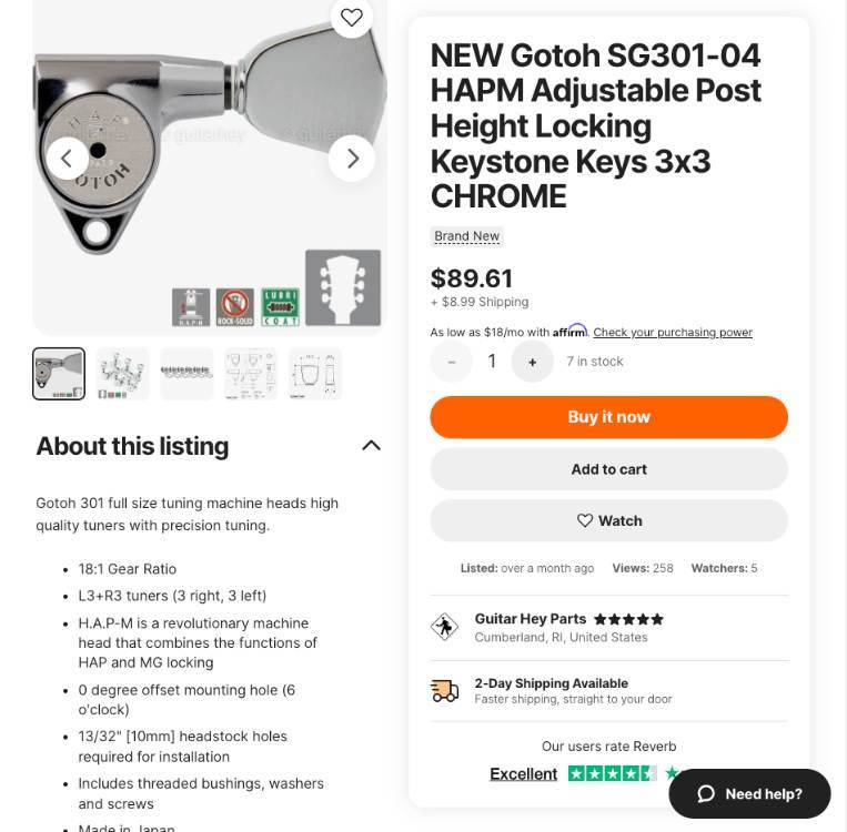

scottcald Posted March 10 Posted March 10 Seems like some locking tuners with taller G and D would do that. Wonder if someone will come out with that? 1 2 Quote
RobB Posted March 10 Posted March 10 1 hour ago, scottcald said: Seems like some locking tuners with taller G and D would do that. Wonder if someone will come out with that? Gotoh makes those. Look for, "HAPM", in the product description. They are height-adjustable AND locking. The treble posts even have smaller post-holes. Their Kluson-types for Strats are great, too. 5 Quote
