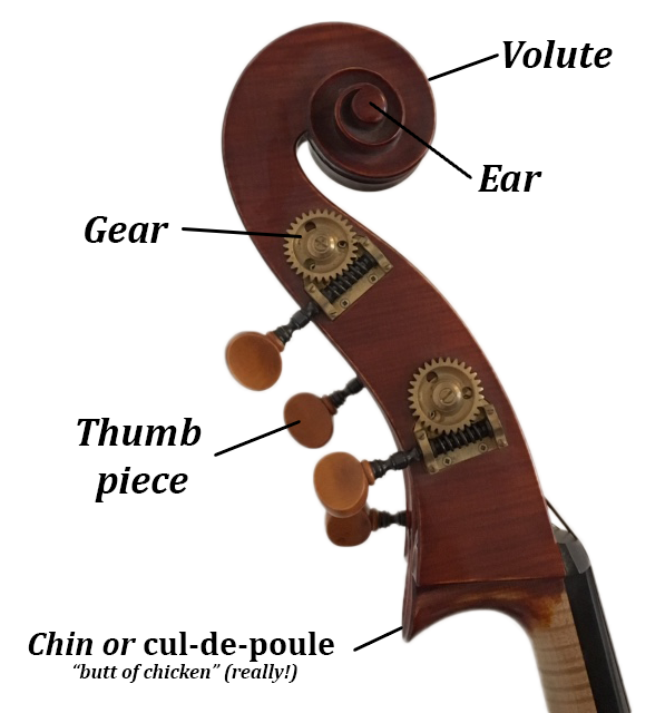

stobro Posted October 2, 2021 Posted October 2, 2021 In the double bass world, the volute is the scroll at the top of the headstock. The flair at the neck-headstock joint is the chicken butt.
Ting Ho Dung Posted October 2, 2021 Posted October 2, 2021 4 hours ago, stobro said: In the double bass world, the volute is the scroll at the top of the headstock. The flair at the neck-headstock joint is the chicken butt. Chicken but = Pope's nose.
