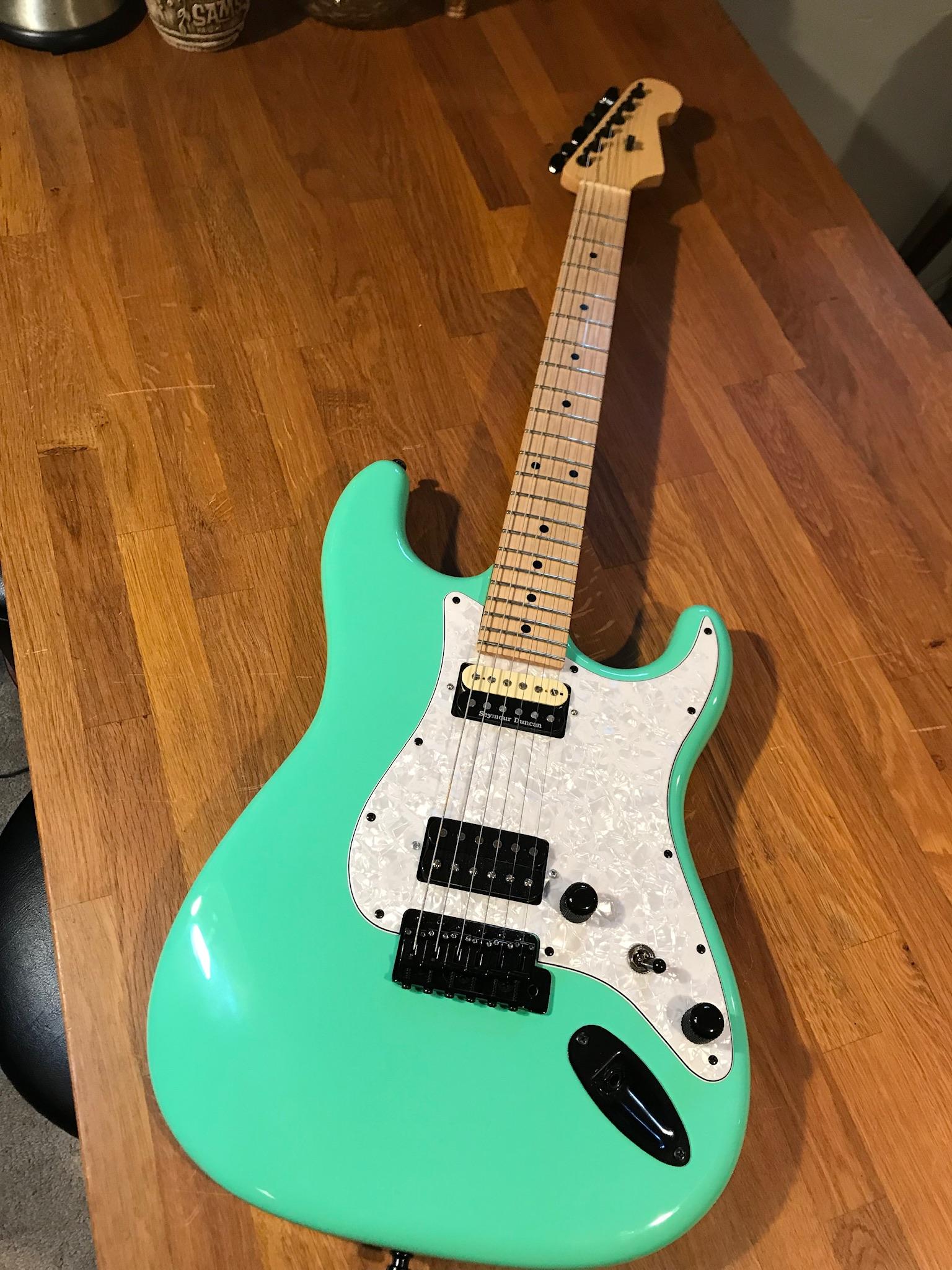

I nabbed someone else's "lost interest" partscaster project, sold off the parts I didn't care for and used the proceeds to fashion something I was interested in playing.
The starting point was a Gilmour Black Strat clone. The builder had (oddly) stripped the (original) black paint from the American Special (SSH) body.  I sold the '57 Vintage Reissue neck and tuners.  I still have the prescribed Gilmour pickup set (I was surprised that I do like that hot Duncan bridge pickup).
(Sorry, that's the best available photo since purging Photobucket).
I then had Terrapin Guitars build a custom pickguard, bought a TV Jones template and had at it!
Then, a quick test:
After wiring up my Gibson with too many choices, I knew I wanted this to be absolutely simple.  No push / pulls, no mini-switches, just five solid pickup choices.
Bridge
Bridge-Middle
Bridge-Neck
Neck-Middle
Neck
Switching was facilitated with a Super Switch (the two-group variant). Not being overly familiar with TV Jones, I went with a single 0.022 cap on the first tone control (second regulated to a "talent" knob that would remain on 10).  In process:
The 0.022 seemed a little dark to me, so I rewired it with a double-wafer Super Switch to facilitate the pickup choices and cap choices.
So the bridge position uses the 0.022 capacitor and the remaining positions use the 0.015 capacitor (a spare from rewiring my '80 Hamer Special around eight years ago).  Oh, and that treble bleed circuit was from TV Jones - works great with their pickups.
So now it's wired up and sounds really nice.  The neck is the Fender-licensed "Fat" neck from AllParts (1" thick nut to 12th fret).  I'm just waiting on some warm weather to disassemble / paint / reassemble.  The color was the subject of an ad infinitum thread a couple of years back.  I'm still waffling between translucent white (aka Mary Kaye) and Sherwood green.  An interesting additional choice I was considering (and to which the wife rolled the eyes strongly) was to paint it translucent white and then checkerboard it with Sherwood green.  I can see that.
Also planning to have a custom decal made at some point.
Oh, and it now has Fender Tele-style knurled knobs on it.  I have an interesting custom headstock decal in mind.  Any suggestions on a place to get that done?
And thanks for the indulgence.  Kind of slow here at work...

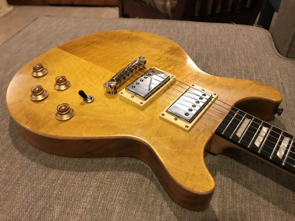

Fast Guitars did the CNC on the body/neck, both in African mahogany. Neck is a '50's profile baseball bat with ebony fretboard and medium jumbo frets. Hardware: Emerson Pro pots, Gotoh strip tuning machines, SwitchCraft jack, MojoTone lightning bar bridge, bone nut, Sanford Electronics 9022 P-90 (A2 mag), 50's Black Beauty tone cap. Finish: 12 coats of Tru-Oil over aniline dye.
Plays and sounds much better than it looks too...

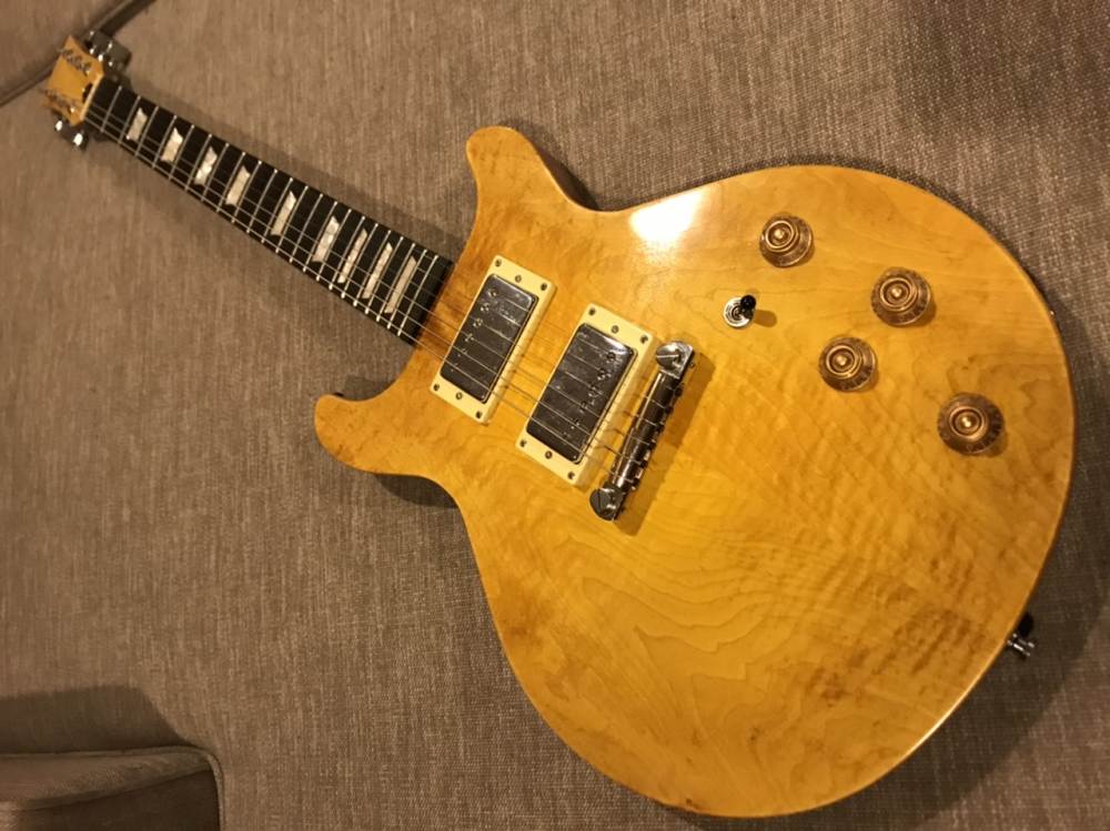

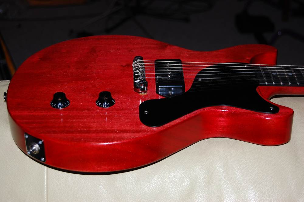

Precision guitar kit I did 2 years ago.  Still rock it daily.  A really nice guitar.  Lightest I own, despite a maple neck.   It is thin though, just right for me.
African mahogany with maple top.  30 or so coats of tru oil on the maple cap.  Ebony board on maple neck.  The most sustain and rings louder unplugged than any guitar I’ve ever owned, including the ultimate junior I bought this year.  I would like to do another but it looks like I’m going to only be building depression style instruments for awhile.

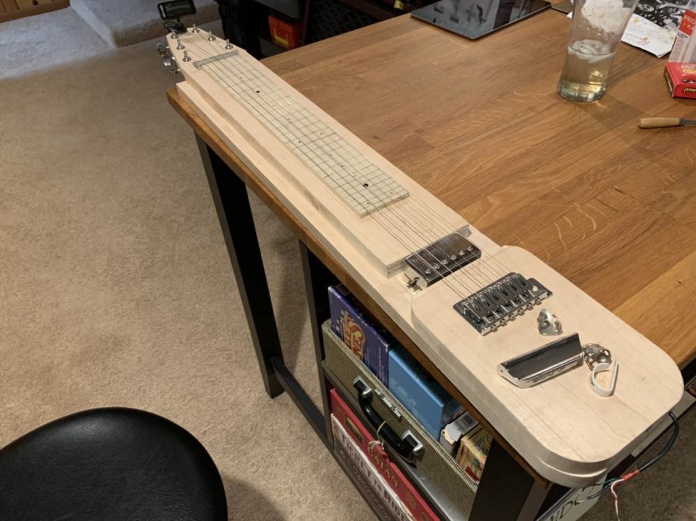

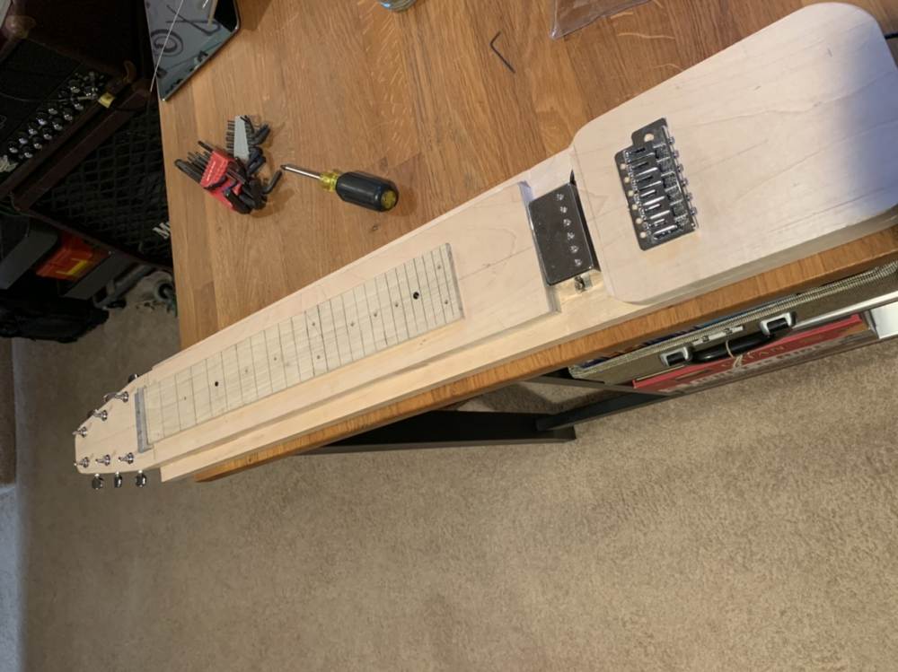

I built this ghetto lap steel today while on quarantine with parts I had laying around

Some, if not all, of San Francisco's Rock'N'Roll Relic Guitars were pre-fabbed by Precision and you can tell that their basic Thunders model DC Jr is virtually the same as mine save one minor detail on the headstock shape and a multi-ply guard (I have a 50's carve thick neck, ebony board and vintage BB cap to my guit's credit). Their relic'd Thunders model list price is US$2,400 while my build cost less than US$400.

If you go with Precision, their '59 neck carve feels perfect, a great compromise between the 50's and 60's carves (thanks for that, Capt. Obvious!).  Anyhoo, that's what I have on my Explorer Jr. and I could play that sucker for hours and still feel cramp-free. Matter of fact, I used it and my SG Special for an outdoor birthday party gig that ran from 7pm - 1:30am and was having such a good time, I didn't want to quit! During a break, a guitar playing buddy asked to have a look at it and needless to say, I had to wrestle it back from him and his friends to play the next set. 😎
FWIW, if I had to do it all over with Precision, I'd probably opt for African mahogany over Korina/Limba as Phil couldn't source any larger pieces of Korina in order to make a one or even two piece body.  At least he couldn't back in 2015 when I built mine, but I doubt he's stumbled on much more Korina all of a sudden; one never knows, however...

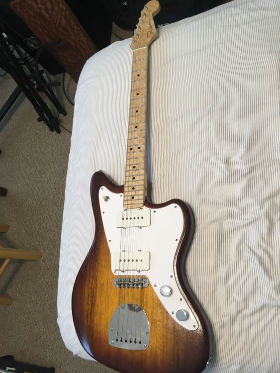

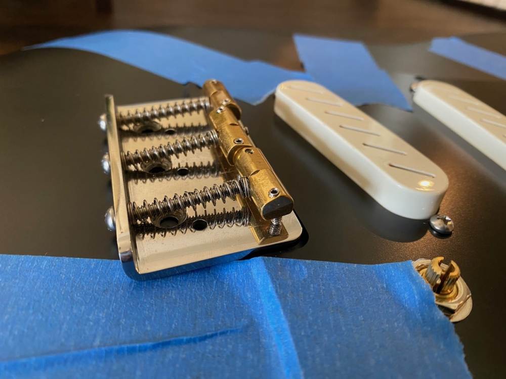

I wired the pickups and switching for this yesterday.  Pickups are Zexcoils (Vintage Single 5's in the neck/middle with a Juicy Bucker in the bridge).  I used a Fender S-1 switch for the volume pot and wired it to activate the neck in any position when engaged.  Pickguard is matte black thick single ply, body is KNE swamp ash hardtail, neck is Musikraft.
I had CHS Guitars spray a matte black (he calls it chalk?) finish with matching headstock that turned out pretty cool.  The bare areas of the neck have been sealed but I think I'll do something to make it a little more amber.  I'll probably use a shellac to get the color I want followed by tru-oil.  Frankenstein strats are cool, but Young Frankenstein is a way better movie.
Other than finishing the neck, the only decision left to be made is the bridge.  Choices are a traditional hardtail bridge using a Callaham plate with Highwood saddles

or a Callaham w/ tele-style compensated saddles:

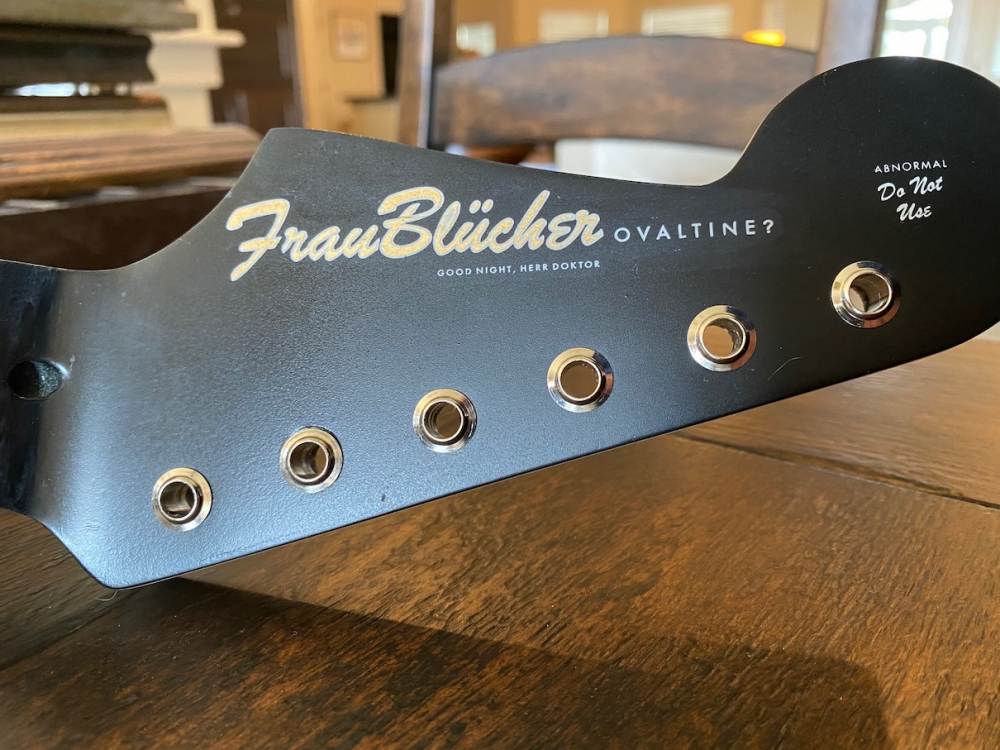

18 minutes ago, cynic said:
Ha!  “Frau Blücher” that’s awesome!
Agreed! F-ing brilliant!

I like the look of those pickups and think the Tele style bridge is the winner, but then again, I hate the bent steel Strat saddles.
