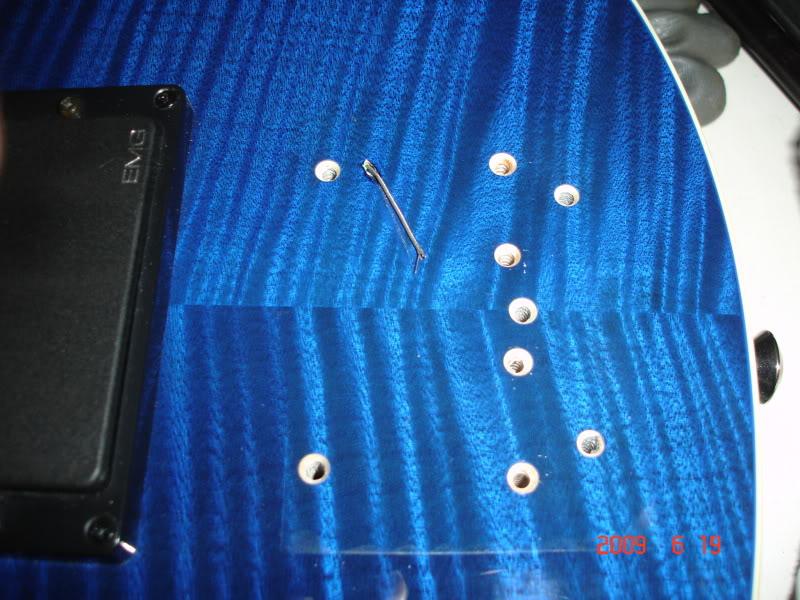

Stike Posted February 26, 2019 Posted February 26, 2019 9 hours ago, BadgerDave said: That does look like TiteBond. Do you suppose someone lost the backplate screws and glued it on? 15 hours ago, bubs_42 said: @BadgerDave, this one looks really familiar to me. I do believe this one has been floating around for a while, the back was a clean as the rest of the guitar a few years ago, then if popped up on Ebay and the some dbag waited 35 years to put a belt belt buckle to it. The bridge is the first I've seen, that is pretty big move and taking a really good look, it probably should be in the middle of those two positions. LOL I guess, you could take another shot at it? LOL I'm kind of thinking there might have been a refin at some point. The pores in the mahogany don't look right, more like sawdust/debris that wasnt blown/cleaned out and cleared over than actual pore filler.
Marvelicious Posted February 26, 2019 Posted February 26, 2019 10 minutes ago, cmatthes said: 1. There were no factory seconds. 2. No guitars left the factory after they were shut down. Once they were done, they were done. This one supposedly left with an employee according to the seller - a member here and former Hamer dealer. Either way, the finish isn't up to par and to my eyes looks like the wood didn't get sanding sealer or grain filler. For the record, the seller was completely up front about the flaws.
cmatthes Posted February 26, 2019 Posted February 26, 2019 5 minutes ago, Marvelicious said: This one supposedly left with an employee according to the seller - a member here and former Hamer dealer. Either way, the finish isn't up to par and to my eyes looks like the wood didn't get sanding sealer or grain filler. For the record, the seller was completely up front about the flaws. That’s different. If it’s the Studio with the Standard headstock, that wasn’t built at the Hamer shop.
bubs_42 Posted February 26, 2019 Posted February 26, 2019 On 2/24/2019 at 8:15 PM, Jakeboy said: What is the debris in the rearmost screw-holes? Is it solder? That is a hot mess.... You need to stop this whole thread and just drive over there for an "In Hand" inspection. Its only and hour away.
Jakeboy Posted February 26, 2019 Posted February 26, 2019 Oh shit! Bubs is right! It is only an hour away...but Wood glue holding on the backplate? Solder in the old bridge screw holes...it looks like they ran the bridge ground into one of the holes....the wiring looks messy....but the price is right if you move it over a decimal place. This thing stinks to high heaven.....sirens, red flags, and buzzers are all going off.....

cynic Posted February 26, 2019 Posted February 26, 2019 3 hours ago, Drew816 said: I didn't know anything about the 79-80 bridge mess That's because there was no 79-80 bridge mess

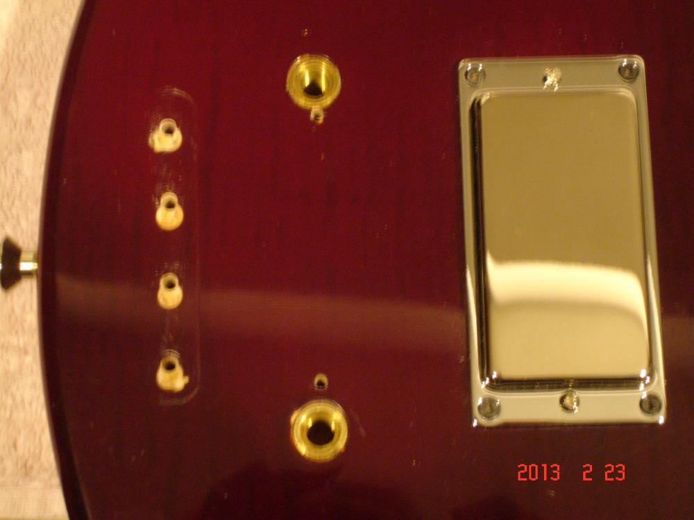

mirrorimij Posted February 27, 2019 Posted February 27, 2019 At first I thought it looked like wood grain filler that leaked into the cavity and wasn’t wiped. It really does look like titebond. I wonder if Steve could shed some light on the ghost image of the second bridge placement.
tbonesullivan Posted February 27, 2019 Posted February 27, 2019 Looks like the grain filler on the back is dripping into the control cavity? Almost looks like they were trying for a "limed mahogany" type of look. Just.. weird. I would hope that if the bridge was moved at the factory, they would have done a better job of cleaning up, and making new channels for the strings. Something just ain't right about this.
mirrorimij Posted February 27, 2019 Posted February 27, 2019 Why only one set of holes for the grommets on the back? That bridge mount and the string holes are drilled front to back and the string grommets are counterbored using those string holes. There should be two sets unless someone at the factory realized their mistake before the bit went through the back. And on all six strings? Seems unlikely but I’m stumped. I can’t see any funny business on the back of the guitar body.
kizanski Posted February 27, 2019 Posted February 27, 2019 33 minutes ago, mirrorimij said: Why only one set of holes for the grommets on the back? Great question!
cynic Posted February 27, 2019 Posted February 27, 2019 Because there’s only one set of holes for the strings on the front.
kizanski Posted February 27, 2019 Posted February 27, 2019 3 minutes ago, cynic said: Because there’s only one set of holes for the strings on the front. Sure, but the bridge was clearly mounted and in (the wrong) place long enough to make a permanent impression on the top finish. I find it hard to believe it was mounted without string holes and then moved. Could those sting holes have worked for the original bridge placement?
burningyen Posted February 27, 2019 Posted February 27, 2019 58 minutes ago, mirrorimij said: Why only one set of holes for the grommets on the back? That bridge mount and the string holes are drilled front to back and the string grommets are counterbored using those string holes. There should be two sets unless someone at the factory realized their mistake before the bit went through the back. And on all six strings? Seems unlikely but I’m stumped. I can’t see any funny business on the back of the guitar body. Looks to me like someone widened the top openings of the string holes with a rasp rather than redrilling.
cynic Posted February 27, 2019 Posted February 27, 2019 45 minutes ago, kizanski said: I find it hard to believe it was mounted without string holes and then moved. Could those sting holes have worked for the original bridge placement? What I see is the original, factory drilled bridge mounting holes and string holes that correspond to the first impression. The only drilling done beyond that was a very sloppy, crooked, non-factory, templateless effort for three additional bridge mounting holes. No second set of string thru holes were ever drilled, the originals only mutilated/modified to "work" with the second bridge location.
BadgerDave Posted February 27, 2019 Author Posted February 27, 2019 On 2/25/2019 at 8:59 PM, Marvelicious said: This one supposedly left with an employee This is an interesting possibility. Maybe the guitar was ID'd as defective by Hamer QC and an employee was allowed to keep it as it was assembled with the bridge in the wrong position. Or possibly it was an employee build and he messed up the bridge placement. Either way, the guitar may have left the factory prior to the "repair". The funkiness under the bridge could be a later amateur attempt to fix the intonation problem. 🤓 Pure speculation, but it makes more sense to me than assuming that anyone at Hamer did the rough cutting of the string slots or the toothpick and solder screw hole patch. And I agree that the seller took the high road in the listing by showing clear photos.
