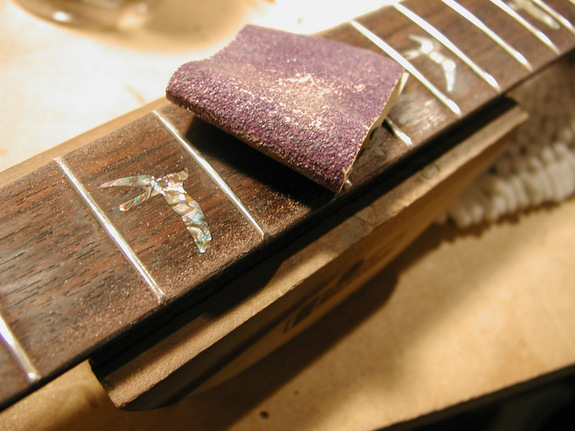

BadgerDave Posted January 26, 2014 Posted January 26, 2014 On a guitar that already has finished fret ends, the process of rolling the fingerboard is much easier. I use drywall sandpaper, running it all along the edge of the board and rounding the fret edges at the same time. Of course, I finish with higher grit papers to give it a smooth feel.Aggressive is good in this case. Nothing makes a guitar feel as comfortable as rolling the fretboard edges, IMO.

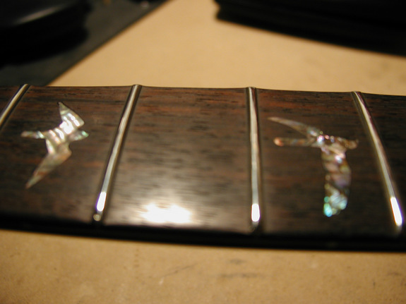

Ting Ho Dung Posted January 31, 2014 Author Posted January 31, 2014 Thanks for the photos, Dave. The video is helpful too. Not sure if I'll take a carpet knife to the guitar though.
