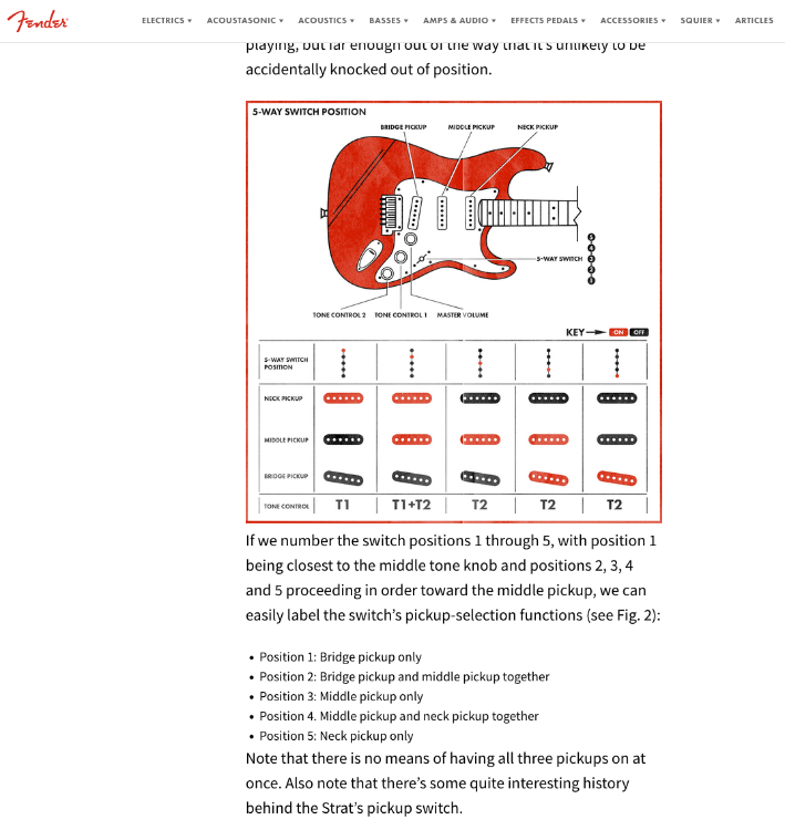

I guessed you were all wrong about this 1=Neck thing.
A quick visit to Fender.com proves me right.
Interesting, I've always called bridge position #1.
Can I correctly assume then, from the above discussion, that Bridge = 1 is the Metric equivalent?
My MIM mutt '69/'72 Hybrid Strat has a three-way switch, so I don't have to worry about five there.  I can still do the in-between positions old-school style, though.  My MIM Gilmour Black Strat semi-clone has the standard five-way switch plus the mini-switch for having the neck PU always on if desired.  So i either have not enough choices or too many to choose from. :wacko:
Bridge is 1 neck is 5. For decades I simply assumed it was the other way. I was wrong. Bridge is 1 and start from there.
