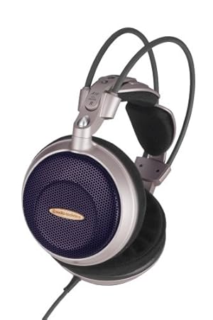

I can't speak to monitoring use, but I use the ATH-AD700 for listening and am still in love with them.

If you don't mind the size, you might go with Feynman's suggestion of the Audio Technica ATH-AD700. When they came out Stereophile Mag instantly named them a Class A recommended component. I've heard they're also very comfortable.
